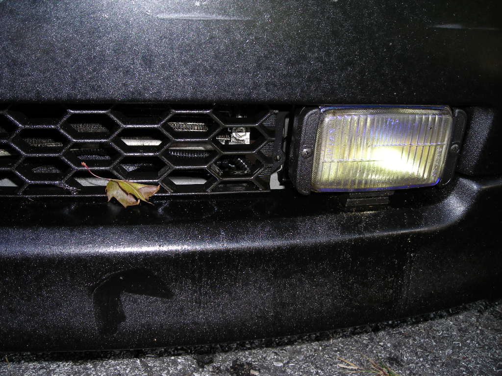

Just to show you what the BOV blowing off oil all over my front bumper looked like.

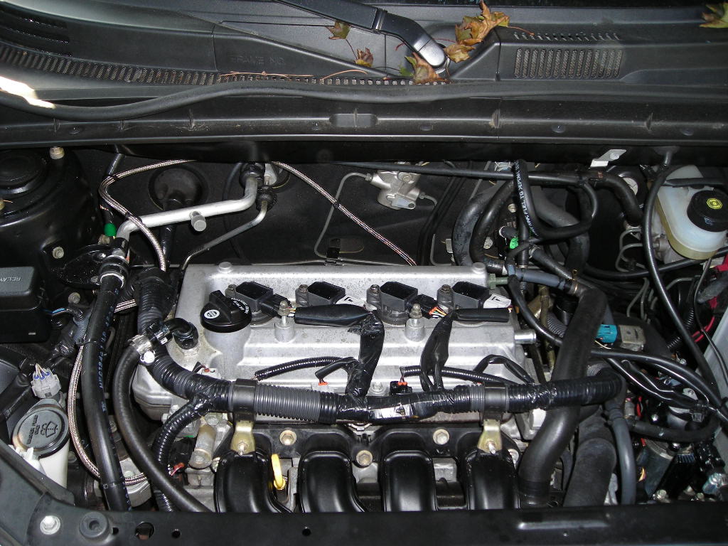

Last shot of the engine bay set up for JDlong

So far tonight I removed : Oil feed line, valve cover, intercooler and related piping, oil pump and some vaccumn lines. Tomorrow I get to get underneath and tackle removing the entire exhaust system, removing the e-manage and replacing the injectors.

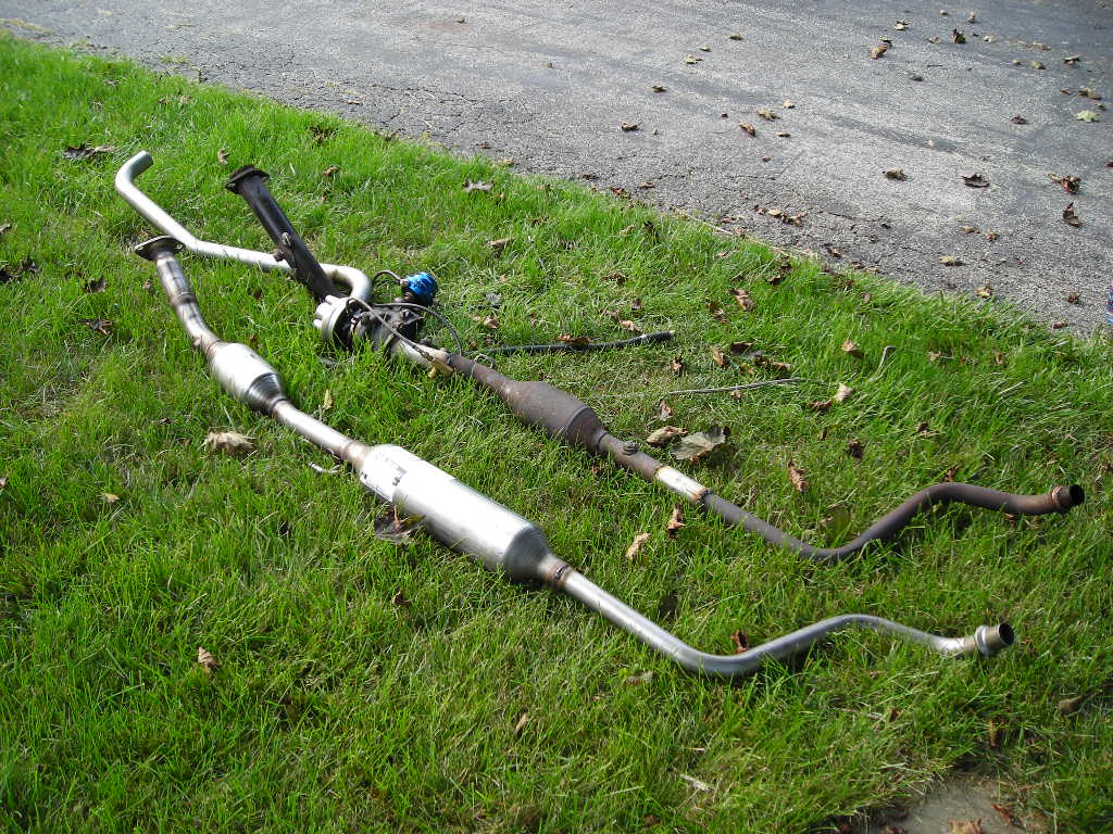

I have conquered the beast!
Just to give ya a comparison shot of what was done to my exhaust for the people that had questions.

Thanks man!
LMAO at the shirt comment...
So, that leaves me with two questions for you. Were you just running cat and no muffler? And do you have a pic of the emanage harnesses wired up? That part still makes me a tad bit uneasy. Thanks again.

Cat with no RESIGNATOR. TRD Axle back.
