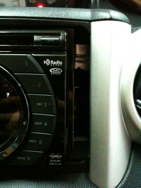

I took everything back out and tried to install the side brackets, but it looks like I'm missing something. I am using the factory metal mounts for the head unit, which are not able to be used at the same tine as these side brackets. The brackets would close up most of the gap and look nice but if I install them then I can't use the factory metal head unit mounts that attack to the sides of the head unit. This results in not being able to mount the head unit in the dash. I guess i can do more searching to find more install parts, but right now it's going back in like it was, sticking out a little and gaps on the sides.

Here are some pics of what I'm talking about. I could probably cut off the mounting part of the plastic parts from the install kit, but then I'd have to glue them onto the radio and I don't want that. I'm searching for some kind of aftermarket mounting hardware now.

P.S. the top and bottom gap wasn't actually a gap, it looks ok, I was installing in a dark parking garage, after looking at it in better light, its fine on the top and bottom, the gap is only on the sides.

I managed to get the dash kit installed, but I had to saw off about half of the plastic side that is supposed to screw onto the side of the head unit. There is a little slit where a metal post on the factory mounts that these pieces fit onto. The problem was that the dash kit would not fit without being cut because of protrusions from the factory mounts on the sides of the head unit. Install complete and looks pretty good.
