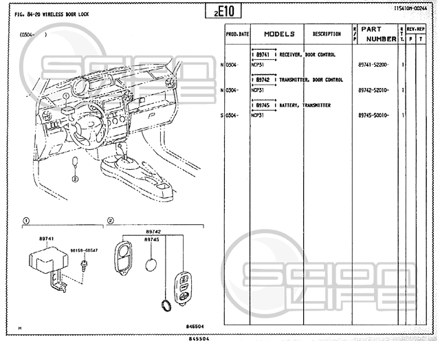

Old Jun 1, 2006 | 08:33 AM
Tomas's Avatar
Admin Emeritus
Posts: 14,570
From: University Place, WA
Yup. As already said, the 2005 came with three keys and two remotes. Those remotes should have a part number of 89742-52010- per the parts fiche, and an FCC ID of HYQ12BBX according to the back of my remote...
Welcome to the family! :D
Tom
