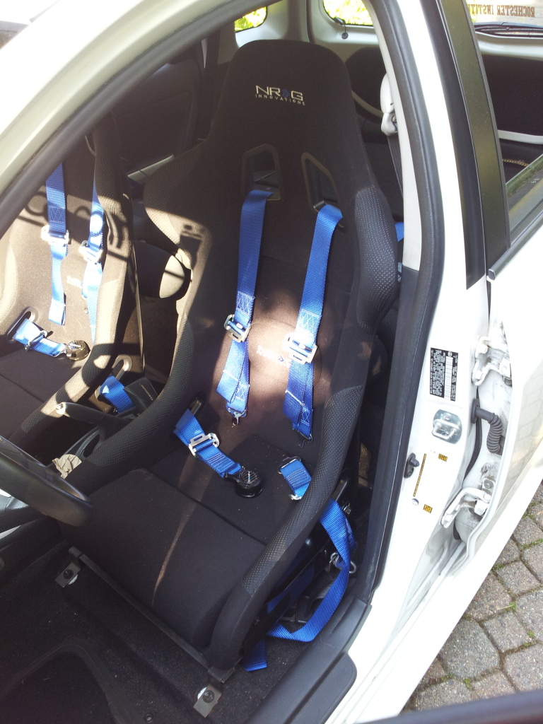

Any pics of your seats installed? Would love to see your set up since not too many people take the time to put them in

yeah no problem, it took some time to install because I had to make custom brackets for my seats.
