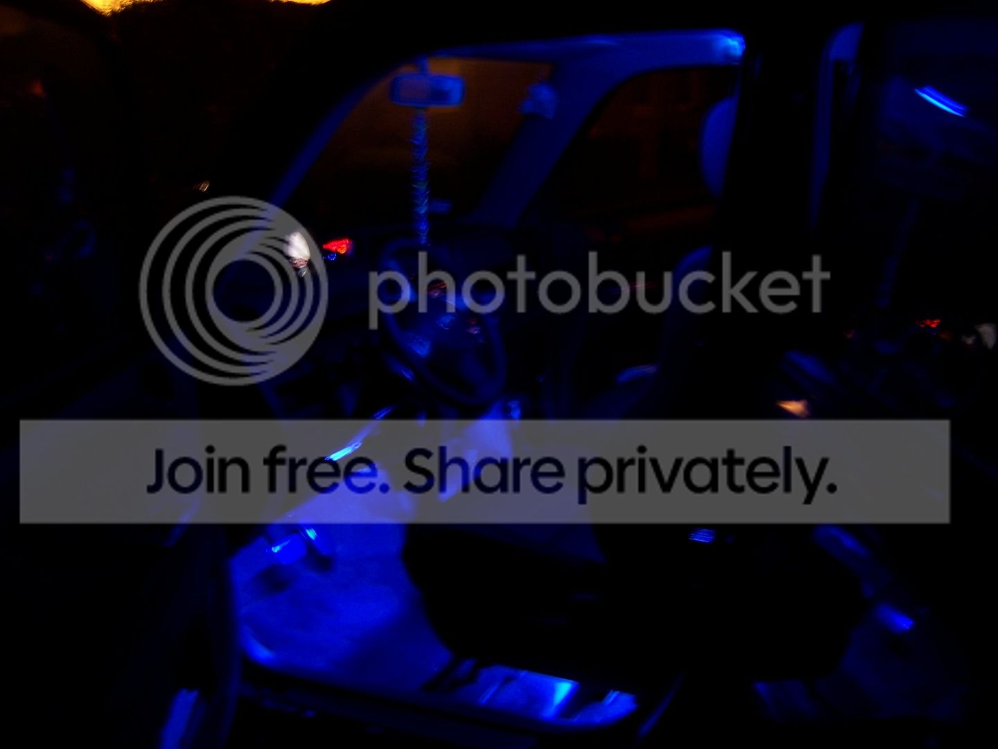

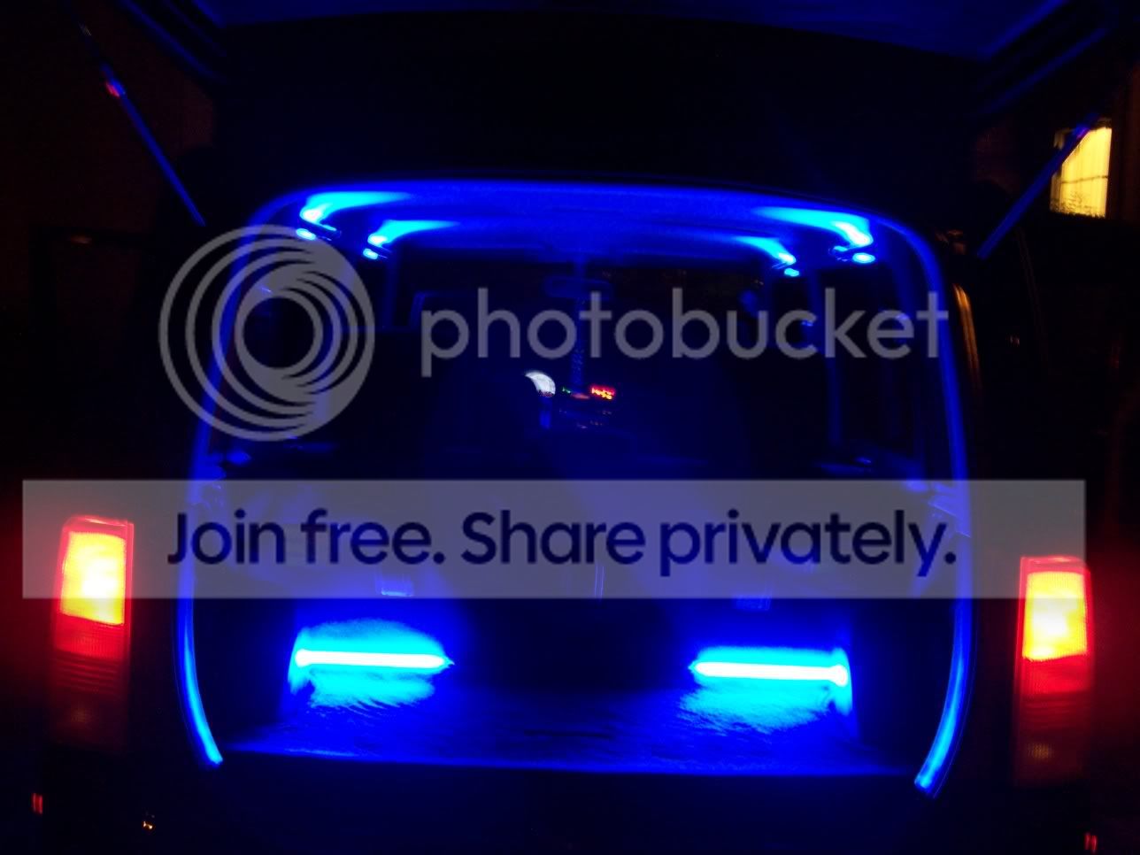

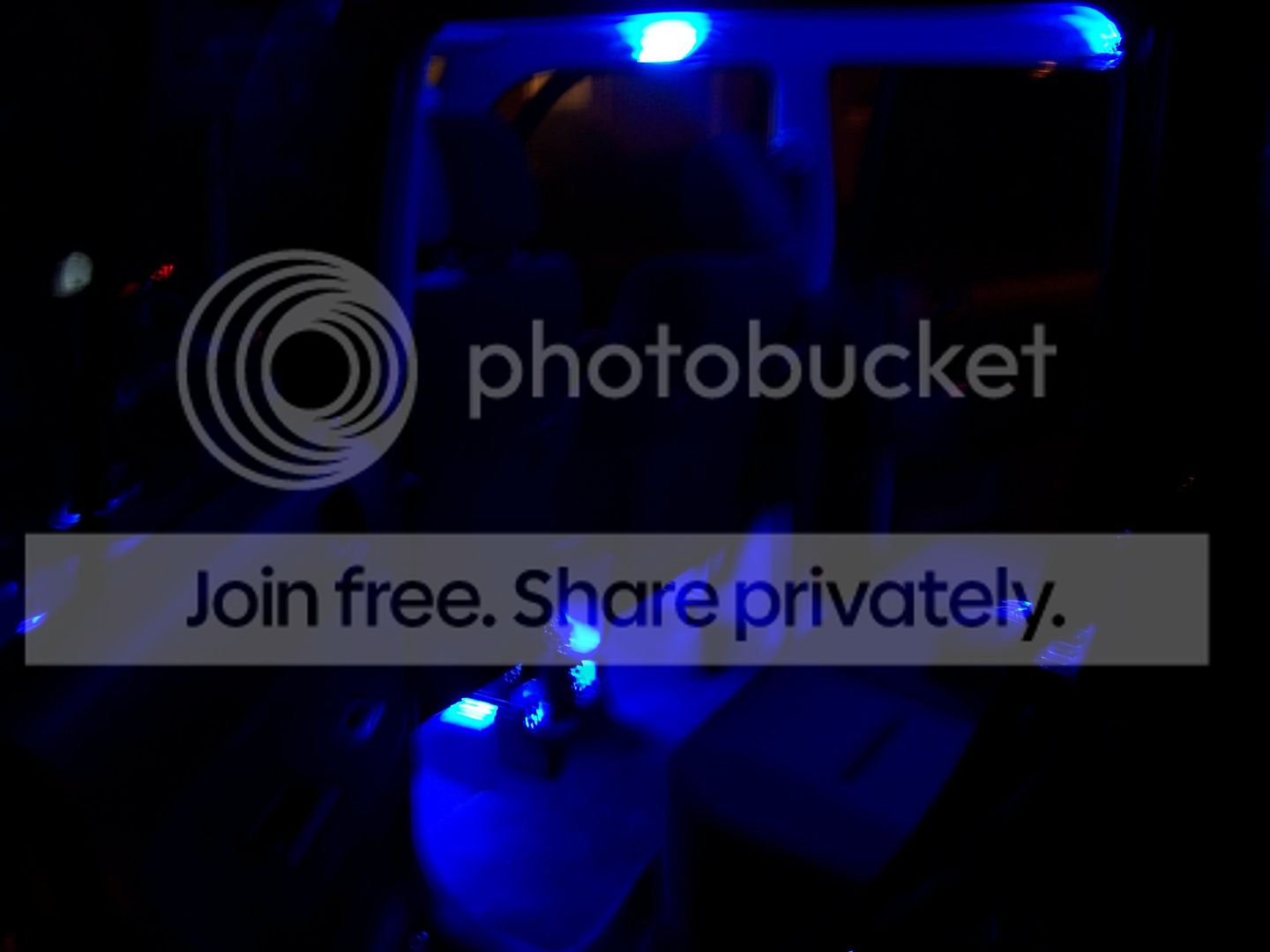

Thanks for all the help, here's the pictures of trunk and handle bars.
I'm not good with the camera, not sure how to capture the cathodes like others can.

I think those are Cathodes, not LED's Bird.
But I second his questions, how did you end up secureing the cathodes to the handles? also in the cargo area, how did you secure the 12" cathodes?

They are cathodes as D_M_A_N stated, and to do the handles I just followed surfcitylocal's DIY Guide.
https://www.scionlife.com/forums/vie...391&highlight=
They are secured by removing the handles then reapplying them. For the trunk, the cathodes are not secure yet.

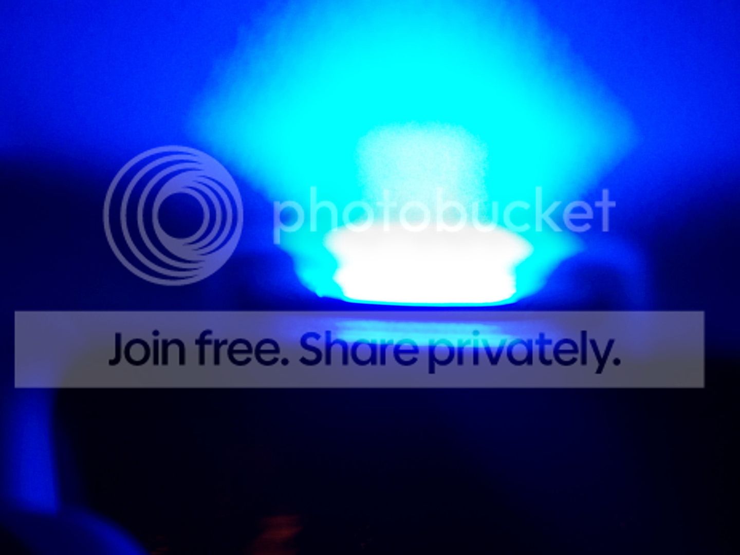

Just finished up some of mine tonight.I have alot more to do, I changed the bulb on the third tail to a 194 fits great and still works good....
P.S. sorry about the bugs LOL
