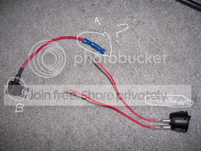

How do I connect the end of the "mini-add-a-circuit" to the end of the switch? I cant seem to get that part....

Old Aug 11, 2006 | 03:36 AM
DiStUrBeD_AzN's Avatar
Unique Scionikz
Posts: 510
A. How do I connect A to the the switch? What does that blue thing do? >_>
- I was actually thinking about cutting off the blue thing then just wiring it that way, would that work?
B. I got a few little "fuses" or "plugs" that go into the spot labeled B, what do those do?
Do I just connect it like this then, use a clamp to smash it together? o_O
Old Aug 11, 2006 | 03:55 AM
Neothin's Avatar
Posts: 7,514
From: Orlando, FL (UCF)
yes, that's exactly what you do. the blue thing is a butt connector, stick the switch wire in and crimp the other side of the connector down onto it. make sure the wire will reach from the adda circuit connected into the fuse box to the switch panel before you crimp it down though. If it won't reach, you have to add wire.
the fuses limit how much current can actually go through the wire. Put either the 3 amp or 5 amp fuse in there.

Can I just use any type of crimper? I don't have a so called crimper, but I have a sort of wrench/clamp thingy. >_>
Old Aug 11, 2006 | 04:06 AM
Neothin's Avatar
Posts: 7,514
I use an old set of dull wire cutters my dad has in the garage. They're pretty dull, so it's an ok crimper. Sometimes it does cut through the butt connector though, so be weary.

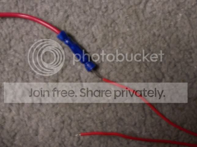

Well I "crimped" it but that didn't solve it. So I cut the blue part off and wired it that way and that didn't fix it.
There must be something wrong with my other wires. That's a REAL pain in the ___ now.
Please tell me if I have something wrong...
Fuse box ---> Mini add a circuit---(red wire)--> Red wire on switch --(other red wire)--> to red wire on inverter --> CC
Ground doesn't do anything other than safety right? It wont affect the lights right?
The Fuse things, which one should I put and where?
