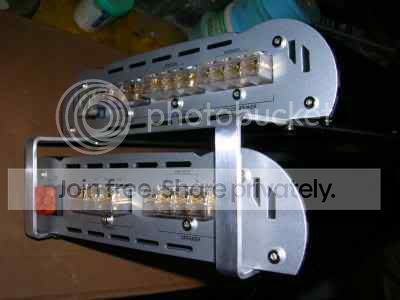

I have a nine.1 and a nine.2x under the pass seat. Made brackets to "stack" one on top of the other with a 1/2" between.
Seem like you should be able to do an amp and your XM on pass side and leave your sub as is. Ditto on nice short wire runs!
