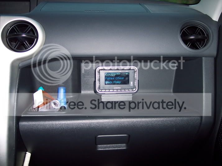

I just installed this Audiovox XR9 into my box this weekend, I will post pics soon, but I ran the antenna out of the passenger side door.... what made you decide on the rear hatch instead? just curious!

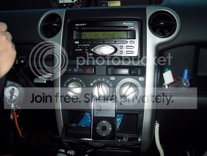

the reason i didn't want to use FM modulation ; was becuase XM radio's main purpose is to give Digital Quality Radio! which is why I hate it that my mom uses the built in FM Modulator to hers! I have mine w/ my ipod hard wired to the HU using the USASPEC product.

ok, i know it's been like 3 months since i last posted on this topic... but i finally got my digital pictures up and ready of my installs....
