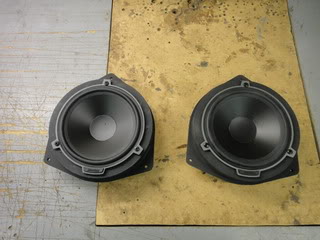

I went with a Boston Pro Series 6.4 seperate setup up front. I tore the crossovers apart and mounted them behind the dash. I mounted the 6" with MDF adapters in the factory door locations. I installed the 4" from the underside of the dash with MDF adapters and made a bridge for the 1" neodymium tweeter to sit just above them. I installed 6" coaxial Bostons in the rear for fill in the stock locations to run off deck power.
