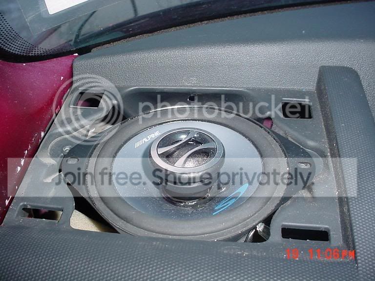

i put a alpine 4" 2 way speaker in there. it slides in and dosnt need to be bolted or screwed in, the way it slides in, the friction holds it good, im worried it wont come out now. after breaking off a tab off the cover, it fit over the speaker, makes a worlds differ.

heres what i got shoved in.
