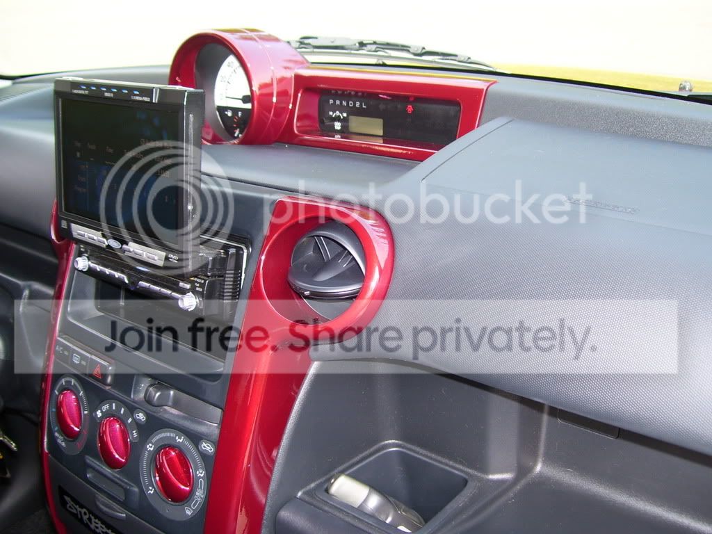

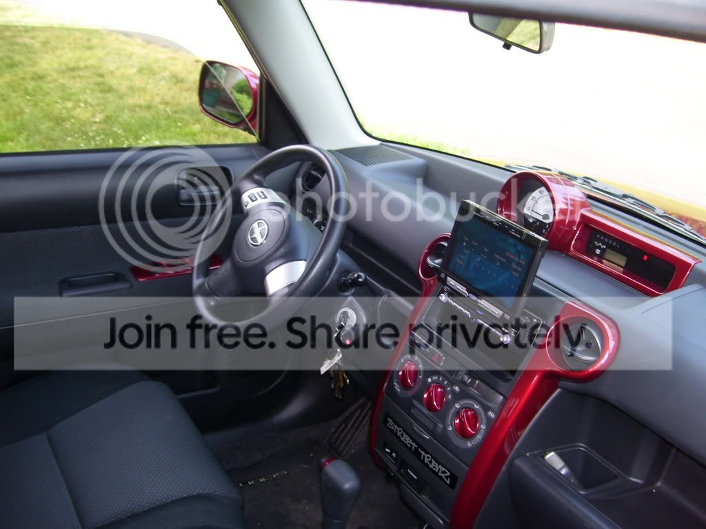

hey guys i started on painting the interior pieces in my xb last weekend they turned out great but I need to do somthin with that steering wheel! cant figure out how to get those grey plastic pieces off. wiil post pics tonite.

cool thanks,going to paint all the pillars dome light the steering wheel pieces and glove box next. will post pics. thanks for all the help
