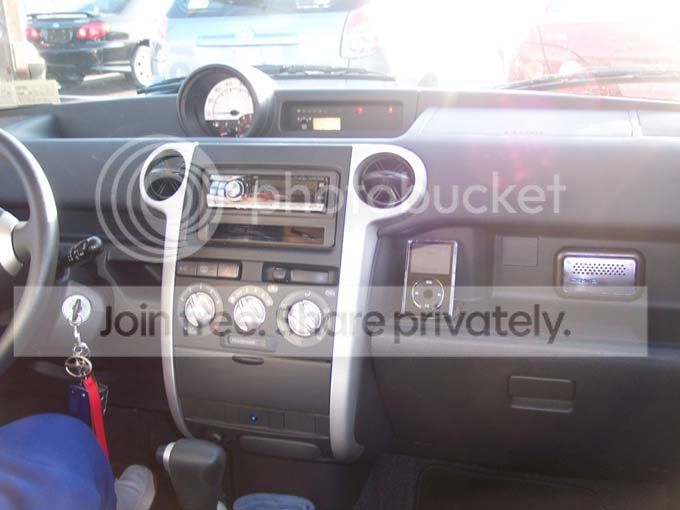

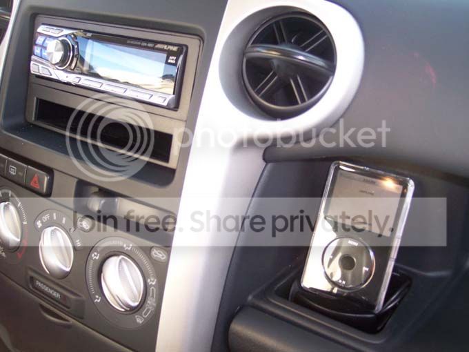

Old Feb 21, 2006 | 08:07 PM
bugless's Avatar
Posts: 13
Default custom iPod dock
blueboxerxb,
Here are some photos of my nano install. I had to cut out quite a bit from the back of the ashtray and on the front bottom of the ashtray immediately behind the handle for the ashtray. I am also using a ground loop isolator since there is noise when powering the iPod from the car's electrical system. I got mine from crutchfield for about $15 and it works great. Let me know if you have any questions about the install.
bug

bugless, I dont think that I will invest on a nano due to my budget what do you think abt a custom fiberglass dock, I will just run the dock connector to fiberglass base.
Old Nov 24, 2006 | 08:31 PM
ltj42884's Avatar
Posts: 192
From: Aston, PA
I took out the ashtray and fabbed my own tray using the ipod dock. I fit a fullsize ipod in it no problem. the only issue is that the setup I use wont read the ipod through the dock. its not a fancy thing but I could prob get a couple pics and send you the dimensions and all for it
