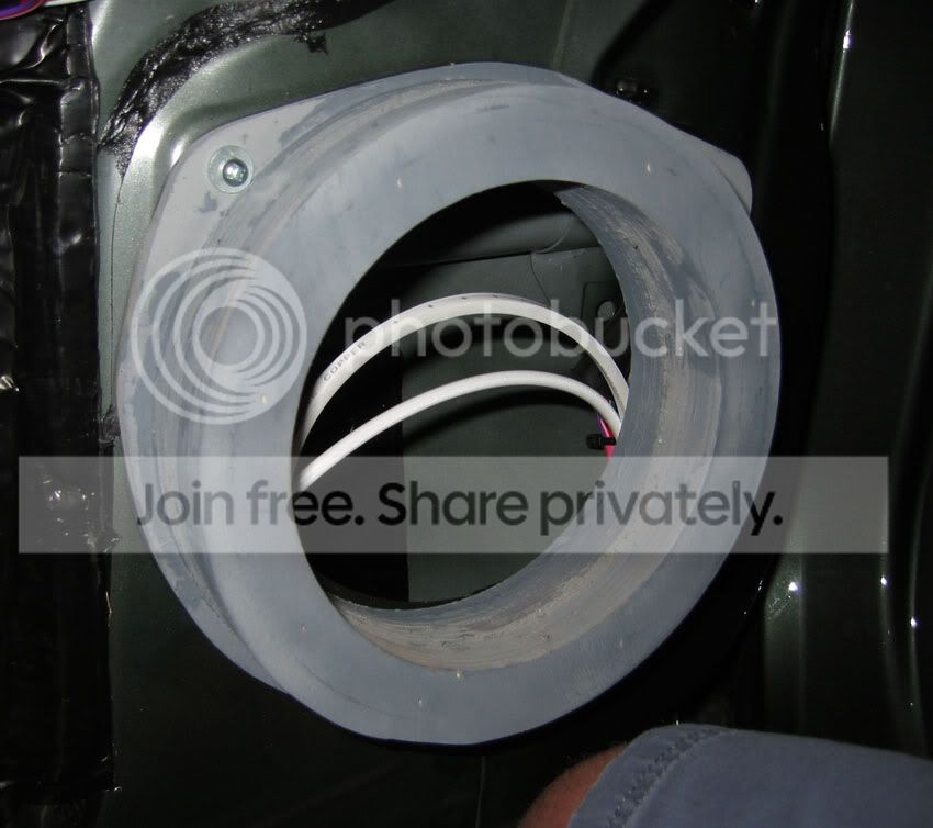

they need to look like this. these are cut on a router and are two pieces glued together. very strong and will set you back $50.

you don't even need the 2nd piece... single 3/4" will do just fine w/o mounting issues... with the 2 piece as pictured, you could fit speakers up to almost 4" mount depth in there... but that's not necessary...

Well, those allow you to mount back to the factory spots and the it brings the speaker back to the door panel so it's not sunk in the door. Hey, it's how we do it at my store and you get nothing less than that.

Too expensive? cheap mounts are plastic and cheap. they can crack and they resonate. Now I am not going to create an arguement about who should do what. go cheap and you get cheap. they are 15 to 25 dollars. for a little more, you may get better sound, less resonation etc. it's your guys call on how you want to make your car sound. I except nothing but the best of my abilities and resources.

50 is the rings. as they look in the photo painted black.

2 rings only? Plus tweeter mounts? 4 rings? Or exactly in the pic? Thanks for the clarification.

About the mounts, $50 is the ring. that means a piar of mounts. The tweeter mount was an experiment. It worked out nice though. Sooooo, you can say this or you can say this or you can do this I don't care. I have obesrved a lot of cheapness here. Say what you want and do what you want. Don't let me catch you complaining about what you did and it doesn't work right or rattles or whatever.
