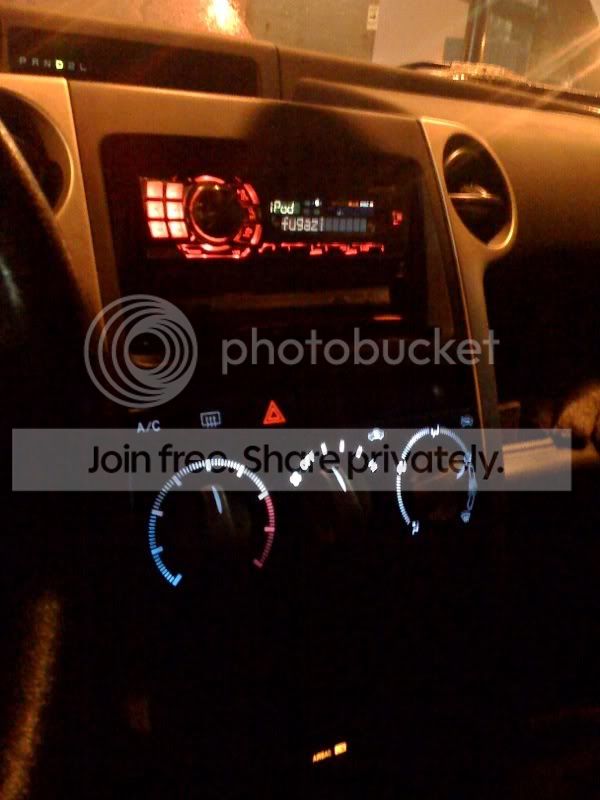

Originally Posted by jsa3mm
Sorry the picture is so blurry:
wow, thats a lot brighter than my green ones are. Thanks for the pic, just ordered two!

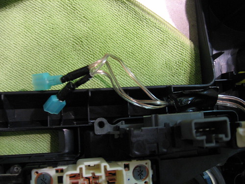

Default ok, here's what I did,
I changed the two bulbs on the back of the a/c controls. (in above pic, the two gray things with phillips heads)
then I used the short flexi led strips from oznium.com and kinda stuffed them down behind the controls, There is a blue led behind the blue temp i used a red led on the red side, of course, and the opposite side has a slightly longer white led strip.
routed the wires over to one side and crimped on some spade ends and put some snap-on taps on the white and green wire from the main (biggest) harness. I marked the posi with black tape
Here's what it looks like, Sorry it's blurry. Very Impressive, much brighter, and cheap!

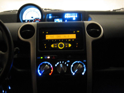

Pic I shot last night of mine.
