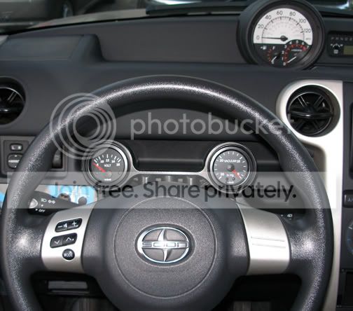

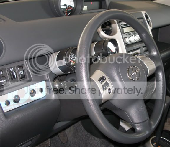

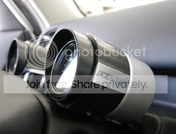

Dual Perrin gauge pod, painted black, with VDO Vision Voltmeter and Engine Vacuum gauges. I had to make spacers to fit in the 52mm gauges and rear caps that were painted silver to match interior trim.

I will post night pics as soon as i finish the wiring. Took me some time to figure out the dimming part since i wanted that to adjust the same way as the speedometer etc.

Originally Posted by B2FiNiTY
Very nice! got a link for the model # of the pod? Did you have to drill or do anything permanent to the car?
http://www.perrinperformance.com/pro...ory=9&model=17
Had to make 3 holes in the top plastic steering column cover.

Are those gauges that deep, or do the caps just allow for A LOT of extra space? My Prosports only go to about the I in Perrin...
Old Jun 3, 2008 | 10:02 PM
Reactor's Avatar
Posts: 682
From: Southern California
Only about 1/4 in free space left behind the wiring. The gauges are not very deep, but the light bulb holder sticks out a bit. The pod didn't come with caps or spacers to fit 52mm gauges, so i just made them out of black ABS piping from H-Depot.
