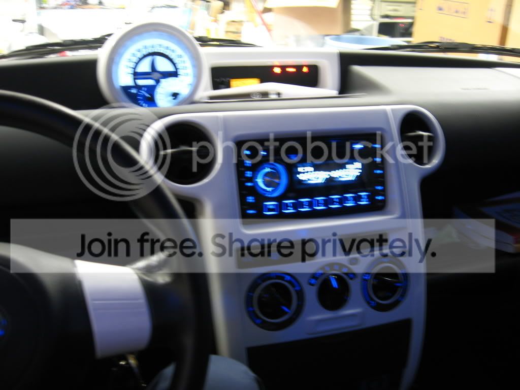

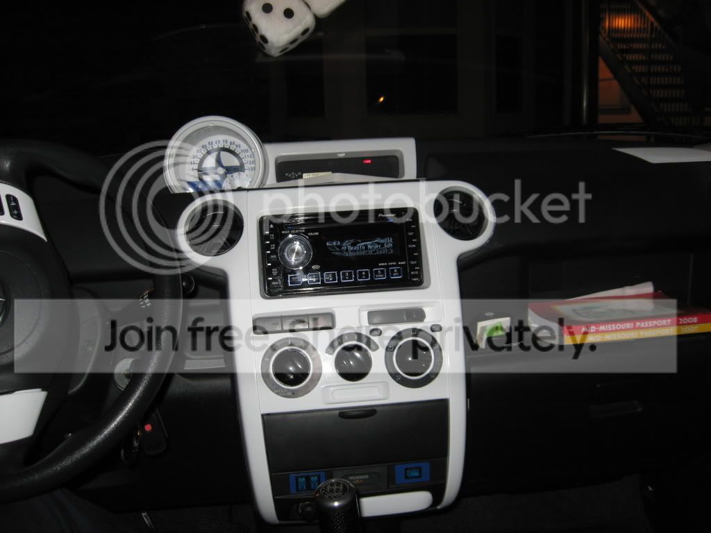

yep i did that same thing a few weeks ago. i painted the thim of the radion, wat silver, i changed it to a nice gloss black
since thease pics ive painter the oven door and everything bellow is a nice gloss black and the knockouts white.

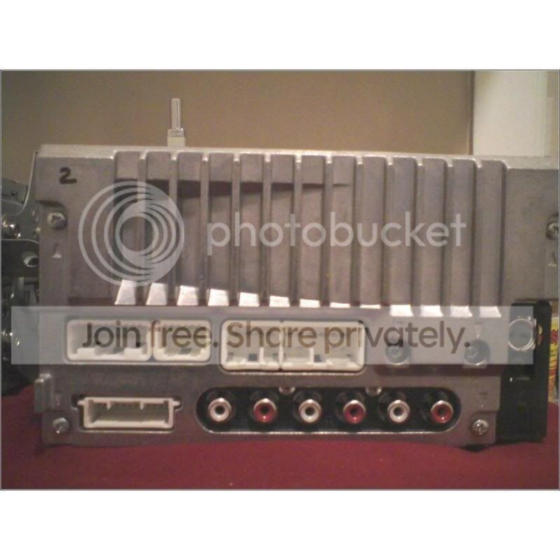

Are the RCA jacks labeled? (Front, Rear, Bass)
Old Jan 19, 2008 | 01:13 AM
  #50
nikbrewer's Avatar
Posts: 210
From: edmond, oklahoma
yes, rca cables are labeled, you also can control sub volume and phase from the head unit

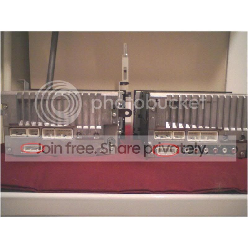

Old Jan 19, 2008 | 01:43 AM
  #52
swartzautoman's Avatar
Posts: 1,915
From: Mid MO
all of the conections on the back of the HUs are the same
the one that is circled is flipped around but is still the same
and the rca jacks are labelled" F, R, S = front, rear, sub. you can barly see the "R"
in the middel of the center set. perfect, what more could you ask for. this is alot of the reason i wanter this HU.

Anyone confirm that this is plug n play with 2005 XB? Just wanna make sure before I get my hopes up, and start searching for one.
Old Jan 19, 2008 | 11:13 PM
  #54
Posts: 1,915
From: Mid MO
its the same dude.
toyota hasent changed any of this type of stuff in long time
