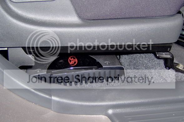

I have the Ebay/Scosche one you linked to above, with a Fosgate 500w amp under the passenger seat. For the money you can't beat it, it actually hits pretty hard. I intend to upgrade the driver at some point, but mated with the stock head unit it's a great solution. PM me if you need any more info...

That looks awesome ... I assume you dropped the ebay enclosure in, and cut a whole in the stock cover to get it looking that clean?

Yeah you need to cut a hole in the lid or else it vibrates like a ****. I also used alot of foam tape strategically placed on the top of the enclosure to keep plastic-on-plastic vibrations to a minimum. After some time tuning it the result sounds very nice, clean to around 30 hz.
