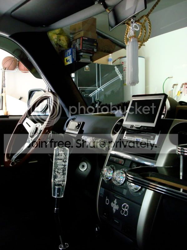

With extension installed:
With extension & aluminum shift ****:
Old Jan 9, 2009 | 02:30 PM

You could get one of the JDM articulated ones.

I made an extra-long-throw shifter a few months ago!
I bought an 18" piece of conduit, some set screws, a tap, and a drill bit. I sanded the whole thing down, and hit it with some rubbing compound to clean it up.
The shift throw is hilariously long, and I love it. My girlfriend gets ____ed when I elbow her in the gut when I put it in reverse, but it sucks to be her.
