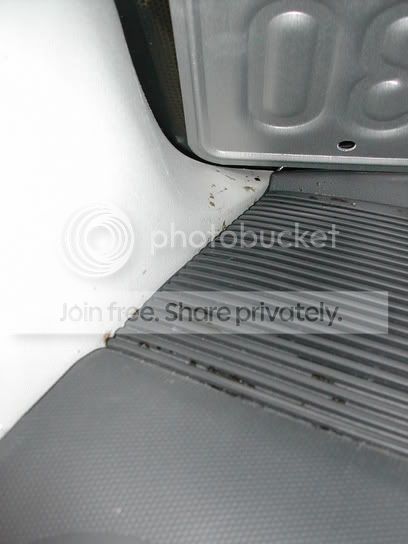

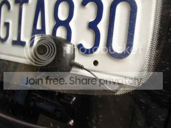

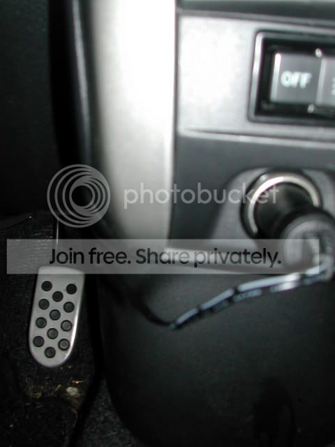

Check it out. Lacking the front mount, we have the front plate in the lower left hand corner of the front windshield. Turns out this makes it a great place to hold the Sirius antenna in place, too (velcro would work, too).

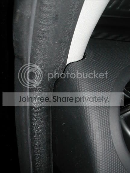

Then, just run the antenna cable down the little panel gap between the dash and A-pillar; I used a small flat-head screwdriver to carefully press it down into the gap...
Took a little extra effort to route it past the curve of the base of the white A-pillar and the dash panel; I just pushed in against the A-pillar to create the needed space.

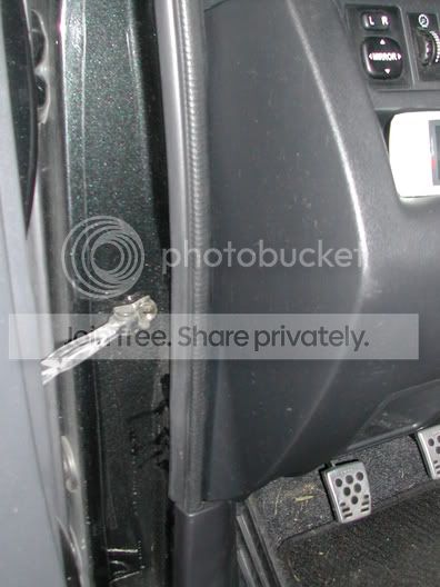

Then run it down the length of the panel gap between the side of the dash and the rubber interior door sill, all the way down to the bottom of the dash and then just tuck the cable up under the dash:
Luckily, the steering wheel is adjustable so you can tilt it all the way down and run the antenna cable up through the gap between the steering wheel housing and the dash. You're doing the same thing with the AC adpater:
I just twist-tied the excess cables for both antenna and AC adapter and tucked up and under the dash panel below the steering wheel (for the antenna) and to the right footwell (for the AC adapter).

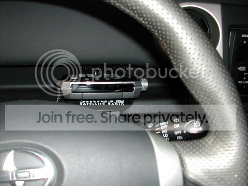

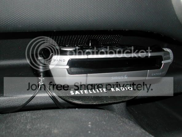

End result is:
Full frontal:
It took about 30 minutes, and that's only b/c I know nothing about installing car stereos so I was super cautious and scoped everything out somewhat carefully ahead of time. It will seriously take about 1/2 that time to just dial it up.
Oh yeah, the Sirus no-skid map was a giveaway at Scion Night II. Thanks, Sirius booth. It helps hold the tuner from skidding around in the little cubby. You could just use some black velcro for similar results. Also, I disassembled part of the dash mount that comes with the Xact Visor and just slid it into the bottom of the tuner to help prop it up a bit. I may add one of the suction cups to tilt it slightly higher.
That's pretty much it for us. Reception has been fine for the most part, although occasionally some stations drop out or have static. I assume this is the case even for external mounts, especially since the newish SIGMA antenna is Sirius' own answer to the interior mount approach.
