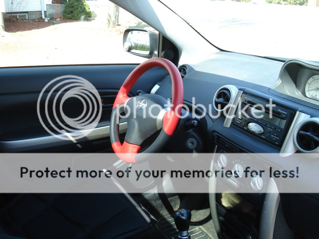

Steering wheel is in and greatly enjoyed!!I cant tell you what a huge difference this has made,its soo much nicer than the stock wheel.Thanks goes out to Gothbox,great working with you on this sale. Very easy install,took me about 10 min
