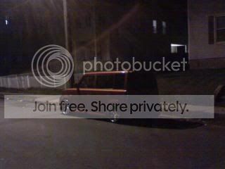

did the install yesterday/night... had a heck of time setting up the coilovers so they wouldnt rub with my 19s but i think i got it... how many xBs have u seen like this? oh and let me know what ya think.. ne body kno how to adjust and fine tune these?
ill get some daytime pix soon

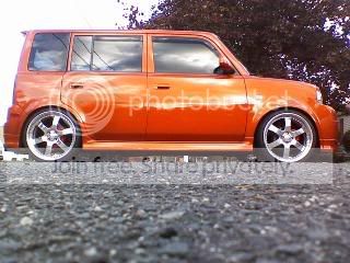

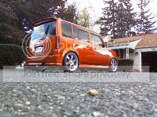

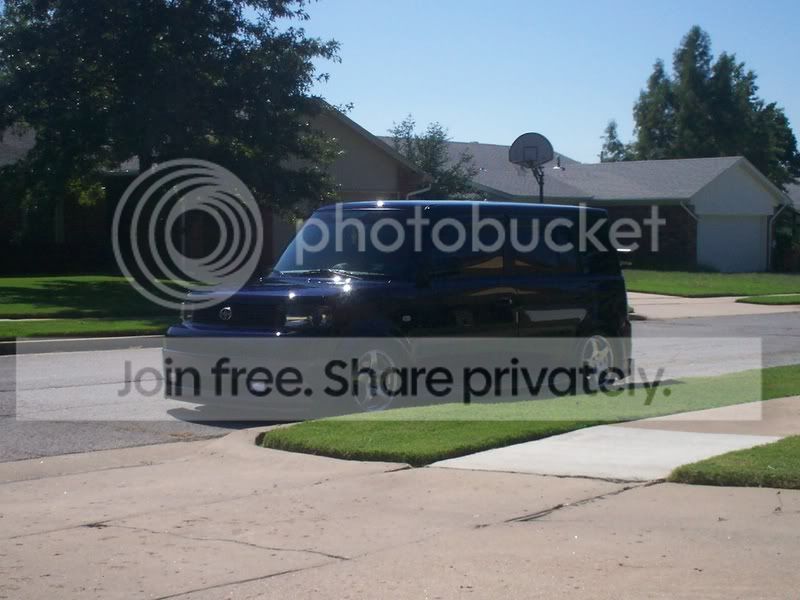

sorry it took so long.. classes this week were crazy... as promised here are some daytime pix... sorry for the camera phone quality..

Wow! Looks great! What did you end up setting the dampening on?

im still playing around with settings on it... in the rear i set all the way hard, and three clicks soft from that point... the front is about the same... im still playing around with diff dampening adjustments.. im suprised how well built these are.. and they match my car pretty perfect...

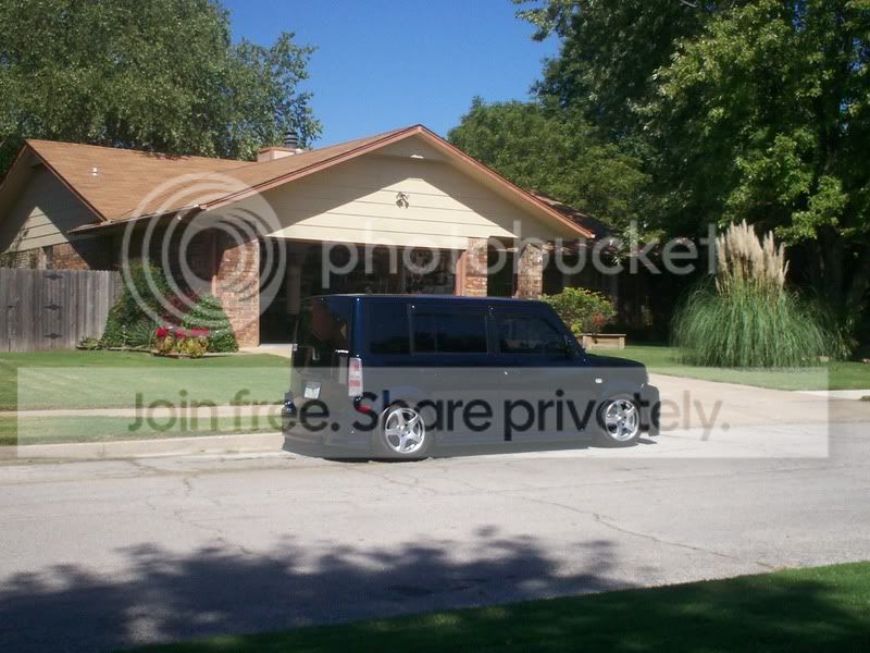

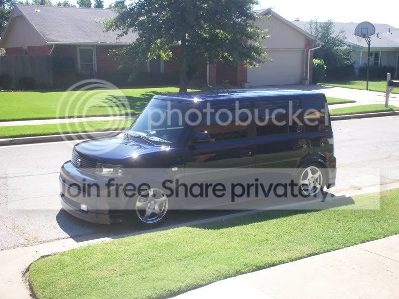

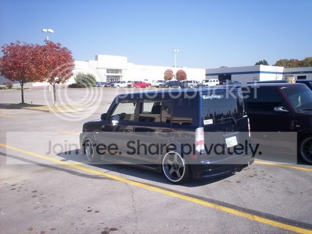

yeah i have ksports on my bop xb, they handle and ride great. but i get alot, alot alot of popping noises coming from the fronts. it drives me crazy when im driving in a 25mph zone and the roads are crappy, they pop and creak like crazy. im going to take them out soon and check and recheck the coilovers and all the suspension components to make sure nothing is loose, but heres acouple pics to show you how i ride:
with 18s
with 15s:

and have about three threads in the back left, and the front probably has an inch or more. i think its a pretty decent dump, and i plan to drop the front just a touch more so its level, currently the back is alittle lower

Hey Tasty, I'm having the same popping noise sounds, but I think I found the problem. It seems what happens is that the adjustable perches that hold the spring up(on the front strut) start to loosen. The more they loosen, the worse the sound gets. I re-tightened the perches and that seemed to solve the noise issue up front.
Lately, the sound is coming back, so I'm afriad I did not tighten them enough, so this time I am going to really snug the perches up on the spring and take a hammer to lock them in.
By the way, very nice ride.

i got my ksports brand new from like $900, i think. yeah ive actually gone through and tightened everything up twice now, and it does seem to help for alittle while. im just gonna have to keep playing with it.
thanks for the comments. yeah i ride pretty low, but the fenders are rolled completely flat and i still manage to rub down to the bare metal, and the fronts have worn holes in the plastics, but oh well, i guess there is a price to pay to roll dumped.
i always say, "if sparks don't fly, you ride to high!"
