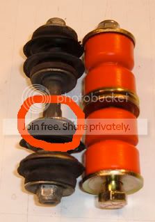

what happen if you dont put grease on the bushings? they scream?

they could squeek

I guess I had a little less showing than you. This is how it looked at first, I have since added a Grade 8 lock bolt so there are not threads showing.
