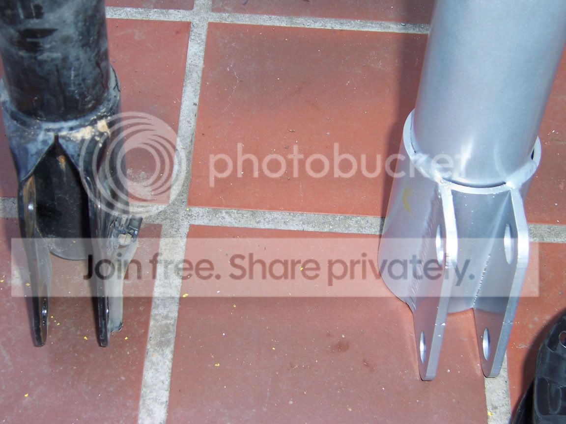

I have installed the Easystreet strutbags an got the car back on the ground(literally). WHere did so much positive camber come from? Is there an easy fix like cambolts or something? I can't rock the spindles in any further. The camber is +1.5 or 2. Dropping the car bows out my front fenders. cuz of this camber and I won't drive it like that anyway. What is the solution?

Easy street got a little happy correcting for the negative camber of the drop. Best bet to correct it is camber plates, but they seem to be somewhat hard to get. I've got camber bolts, but really need more. You really need 3-5 degrees to get it to tuck right.

even with camber plates and or bolts there that problem with the fender being pushed out . you could always slot out the two hole on the bottom of the stru to attain camber .

There isn't much matrial on the Easystreet strut to try and slot. I wouldn't dare do that on a car I had to drive.

a slotted strut , ( only like half inch or less ) is just as safe as airbags , yeah something could pop or mess up but if you do it right there shouldn't be any problems.

Slotting these struts would leave a tiny sliver of metal left on the outside. It might be okay on a show car. But there is no way that would be safe, espeically after you heat it by cutting the slot.

Hotbox, you know my situation, I was about to do that to add more negetive to what I already have and move my new wheels towards body more but nope, I don't think its safe, so I might end up leave it they way it is !!

I would slot the upper bolts inwards!!!

That might work for a little but then you have to think about the bag and body clearance, for some one like me with that much camber already, Sean

yeah, I'm not cutting that strut. could void warranty as well.
