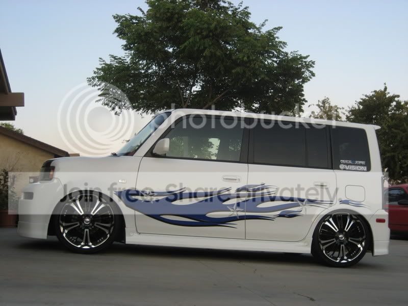

ok so i've had my air ride setup for a little over six months now and i'm thinking about changing out the rear and front. i know i can get a little more drop out of it because i have seen others that are lower than me. a lot of the people i have seen can drop the fender a little past the rim. you can see in my pic the fender sits about a 1/4" to a 1/2" from the top of the rim. i was looking at the fbi mini brackets for the rear. they look pretty good. so does anybody have any suggestions for a front and rear setup?

If thats as low as you go there is more drop in the car yet. My boys xb is that low on springs.... PM me if you want help, I need to know what you got on the car though. Should be able to get more drop with the parts you got, Unless you have Universal air stuff.

I'm not really running any kit in particular. I took it to a local shop around here where I live and told them I wanted air suspension and they did everything. But now looking at everybody else's air suspension setups I can definitely see that mine is not as low as theirs.

notch the front, like they do on the rear in mini trucks and use randodes rear bag setup or go 4 link in the back, there is only so low you can go witha bolt on kit, believe me ive look for room anywhere i can get it and so far randode has the best setup

on the front check to see whats stopping it from going down. With the easy street front struts, the swaybar hits the pinchweld on the botom of the frame, grind out a little notch on both sides for another 3/8"

Definately check the clearence on the front sway bar. Did you pm randode and ask if his new rear brackets will work with your present setup? In order to go any lower you'll have to do some cutting, which at this point I'm not ready to do.I would love go lower but I don't want to remove a portion of the rear spring perches.
