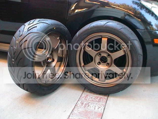

Added another rear bar since the last pics.
I'm also running the TE37s with A048s.
-Pete

does the 2nd rear swaybar actually help that much more.. cause it kinda intrest me alot.. im all about having the best handling vehicle.. and i am willing to sacrafice comfort for that.. but im looking at getting some 8" wide tires on 16" rims first..
Yes, these are the solid bars, and together, they are 24mm. Stiffer than the new hollow 24mm bar. I also went with 16 inch wheels. The suspension is very tight now.
-Pete
Old Jan 9, 2008 | 04:42 PM
  #51
trdsparks's Avatar
Posts: 1,600
From: Myrtle Beach, SC
Those tires are sweet. I'm really digging them...
Old Jan 9, 2008 | 04:48 PM
  #52
PakanaHerruus's Avatar
Posts: 690
From: Simi Valley, CA
what tires are those? and how do they handle in the different types of weather? im looking a getting a set of Falken Azenis RT-615.. i know a few people running these on there BMW's and Mini's for Atuocross, and still use them on the streets, so i want to give them a try..
Old Jan 9, 2008 | 09:28 PM
  #53
Kodokan_4's Avatar
Joined: Aug 2003
Posts: 372
From: Glendale, CA
The tires I'm running are Yokohama A048s (medium compound). They are full race compound, and the tread wear is about 50. They don't last over 5000 street miles, but they are the stickiest, best handling tires I've ever used.
They are VERY expensive, but worth it if you like bombing the canyons or autocross. Because they are so soft, they are not great tires in the cold or wet.
When the weather is cold/wet I'm using Yokohama AVSES100s. They are very good street tires, but the slip angle sucks - so they break loose hard (not a smooth transition like the A048s). The ES100s are mounted on 5Zigen 16 inch wheels.
I think the Azenis have a tread wear of 120.
-Pete
