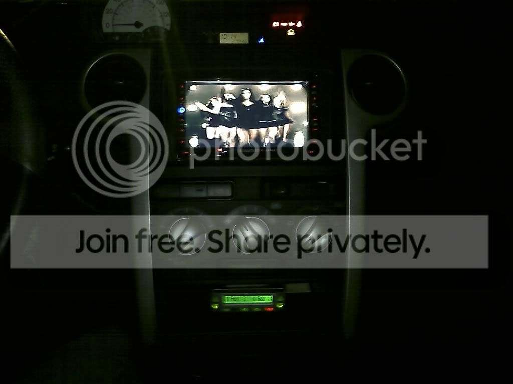

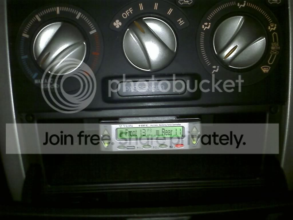

how's it! I did mine almost two years ago and at the time we had to just rush it cause one of our biggest car shows was coming up so here it is. i'll post one more picture.

I still need to install myn was thinking the same spot. but rethinking it now that i see it. that kinda kills alot of free space.

I know it kills the extra space in the oven. I wanted to install mine in that little space right under the mirror switch but the fush box was in the way, another spot would be right by the e-brake but I still don't think would hav enough space. the EDFC controler is kinda big but I think if you have a single din deck then it would fit perfectly in that little extra space.

maby fab up somthing and remove the ashtry.

I wish the EDFC would control the height. it's an electronic dampening force controler, so it just adjust the dampers for the front and back. I use mine almost everyday depends where I drive and how the road condition is. when i'm on a mountain road i'll set it to 2 in the front and 0 in the back so it handles the turns, when i'm in town i'll leave it to a softer setting like 13 in the front and 10 in the back. so the higher you go in numbers the softer the ride is.
