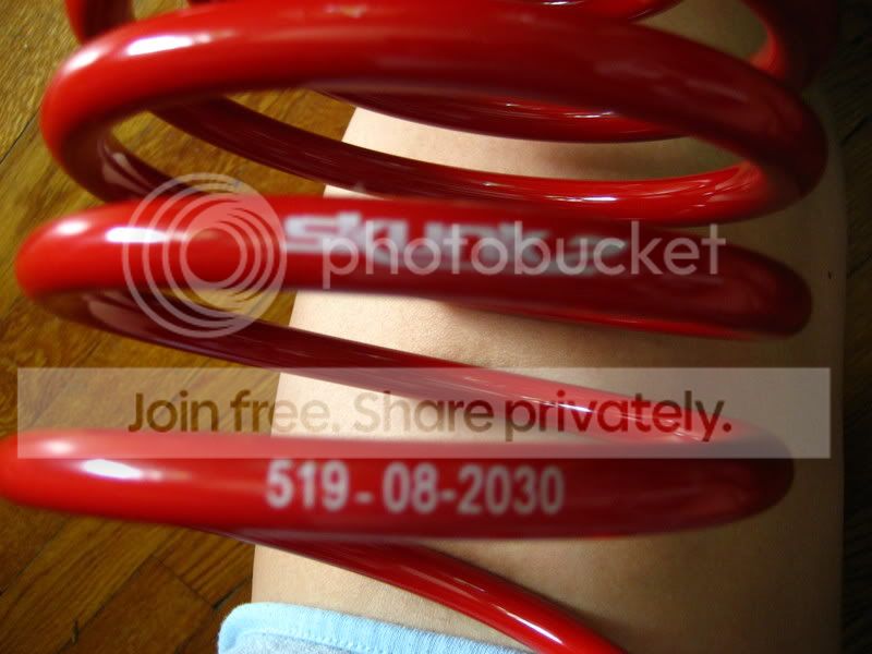

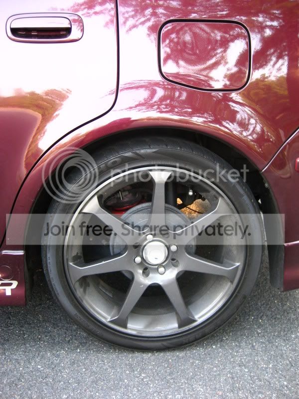

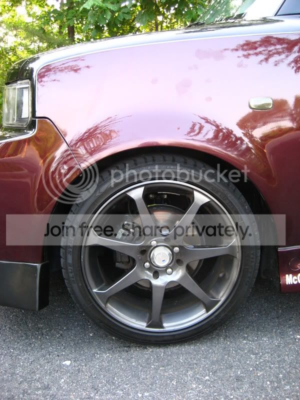

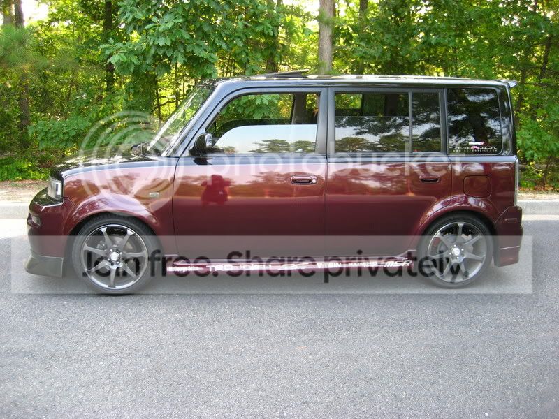

Well to start off, I have been through a couple of lowering springs for my xB. First I had TRD, then I had Tein, and now I have moved up in the world to Skunk2 springs. I must say, I am VERY impressed by these springs. They have given my xB a muuuuch smoother ride compared to my other springs. The springs drop the box about 1.5” in the front and 1.4” in the back. On a side note, the red color is really sexy too! : )
When installing, I had a couple of problems with stripped bolts from a dealership that had put on my TRD’s and did a slack job but everything worked out in the end. I installed the back springs myself and it took about an hour total. The front ones were a little more difficult because I didn’t have a spring compressor so we had to use our mighty muscles to compress the springs when putting them back on (lol). So it would be a good idea to get a spring compressor if you are going to do this yourself!
TRD & Tein vs. Skunk2 ~ Honestly, IMHO, the TRD springs are really not even worth buying. They are what, $250 brand new? And they really don’t give a good drop at all! I loved my Tein springs but I found that they really didn’t ride how I wanted them to. I did autocross a couple of times and they worked OK. I can’t wait to see how my skunk2’s will be in my next autocross!
These springs are only $192 brand new and I tell you now, they are worth every penny! For more info on these sexy red springs, go to this link: http://www.skunk2.com/Suspension/ind...odId=lowspring

After Front
After Rear
After Overall

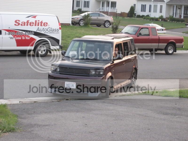

Ok well first off, see the picture below of my car coming into the driveway *before the front S2's were installed* where the lift was. This is when I had the S-Tech's on the front. I had no problems getting in this super deep "ditch" driveway with the S-Tech's on... You can kinda see in the picture that there is a board on the ground so I wouldn't have to scrape going in there. When coming out of the driveway WITH the Skunk2's on, I had no scraping problems either. So it evened out really.

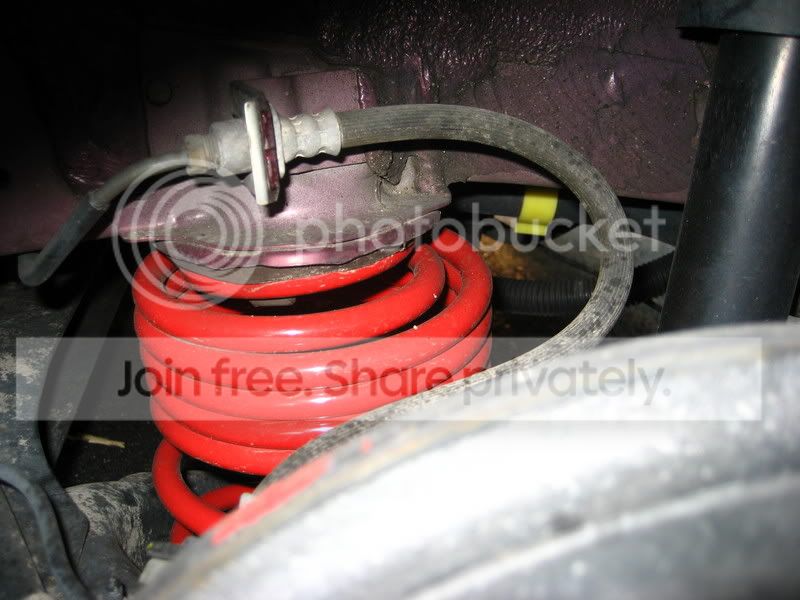

Yea, those two brown pieces of plastic off of the Teins for the fronts...
Some springs, like the DF210 (these too, it looks like) have several dead coils in the rear. Occasionally, these coils rub and make noise. They're under some pretty serious tension so I wouldn't expect them to make too much of a racket.
You saw the plastic sleeve on the back Teins? I wanna say they are the second coil in from the top? It's the same theory.
Anyway, I feel like I'm rambling...
I couldn't find a good picture of the DF210 rear installed, but every other dead coil has a wrap to prevent noise.
See how the 5 dead coils on the Skunks touch? That's what the wrap prevents.
It's by no means necessary to do, but if you do notice noise, that's a fix for it. (it's not like the rear springs are difficult to remove)
