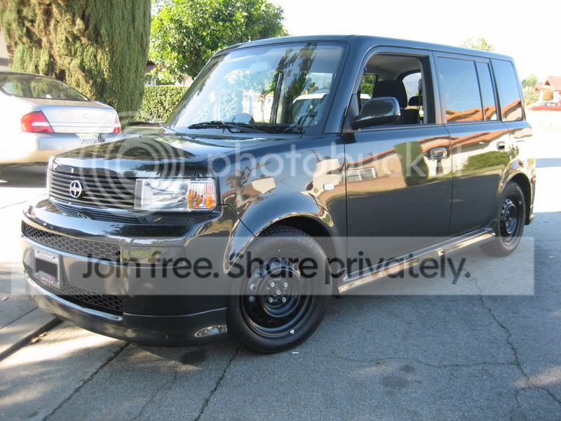

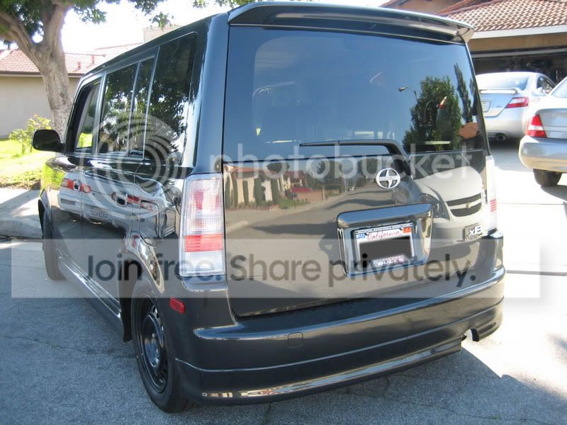

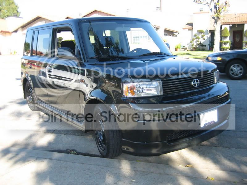

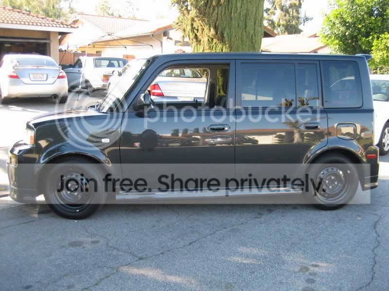

ok guys... i dont have any before pics. i was too excited to remember. anyway:
sport mach springs by swift, moments after completed installation and quick test drive:
they have settled slightly lower since then.
yea, yea... its not really noticeable, but i love it. just as low as i wanted it.

^^^^ ryuji16, how are the springs in terms of comparing to stock ? and as for that drop, i know swift says 1.1 and 0.9 -ish, right ? is that what it's at about ?
looks good, though the rear looks still to be just about at stock height.

yea, the rear is dropped juuust barely. its been a few weeks now and altogether it had dropped just about exactly to what swift claims.
