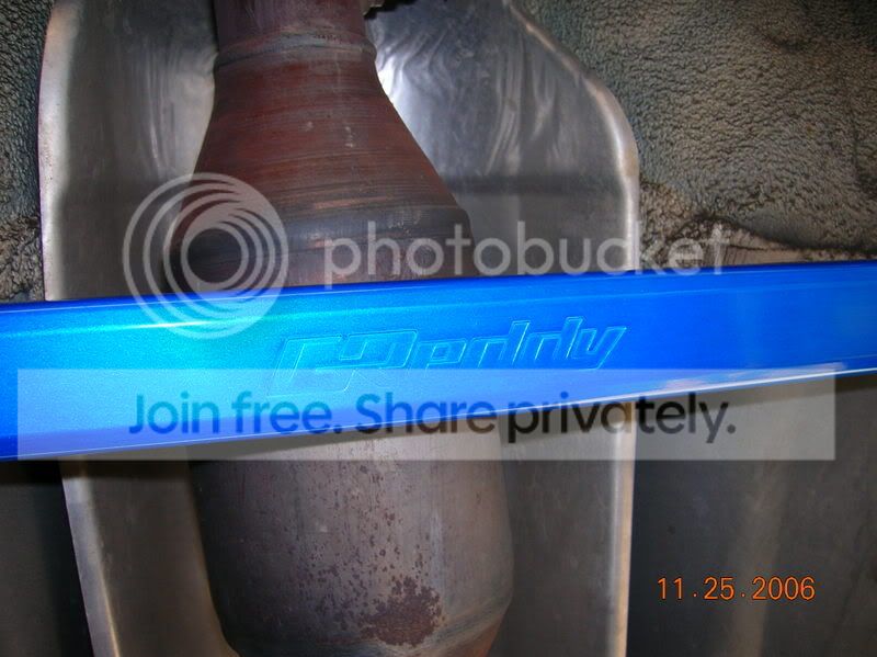

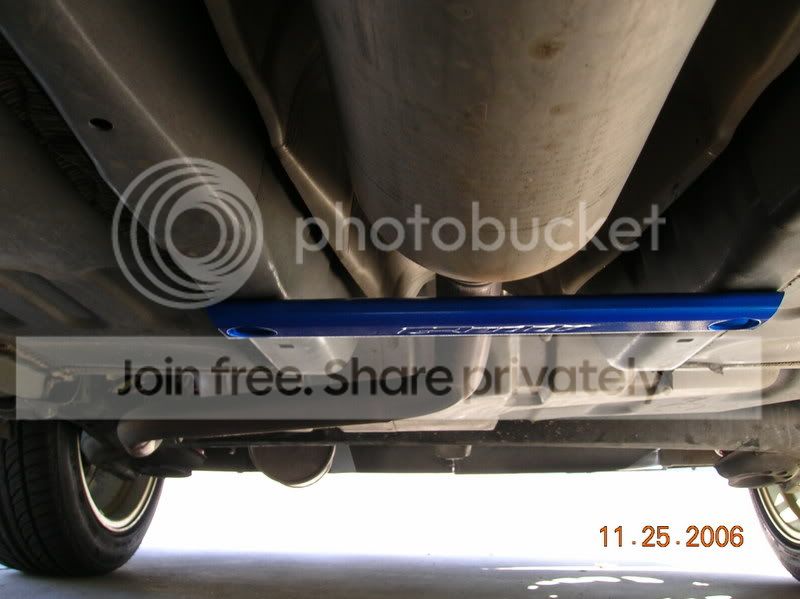

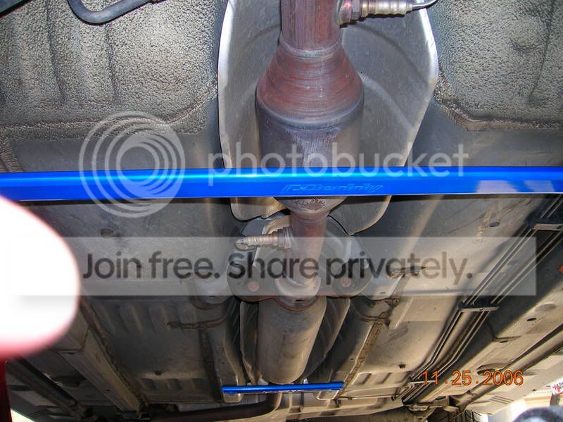

Camp1320-XB's Avatar
Posts: 67
From: Northrige, CA
Here is the picture of the front & rear lower frame braces off my car.
Here is the Rear lower:
& the Front lower:
