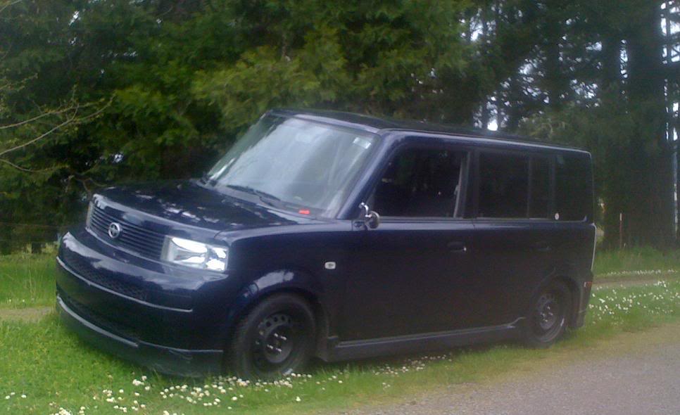

Well, I got tired of the 17" with 40 series tires and just went back to stock 15's with stock 185/60-15 tires until I can find a cheap source for whitewalls. Calli Tire & Wheel in Sacramento is working on a custom whitewall.....
Thanks guys!!Name:  IMG_2789.jpg
