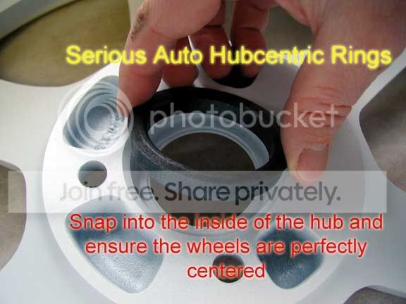

Hubcentric rings are a ring that take up the gap betewwn the innermost area on the wheel/rim and the snout of your hub. It makes it so that the load of the vehicle is not resting soley on the wheel studs. This picture should help you out a little.
As for the spacers, yeah, the wheels in question will sit inward a bit farther than you'd probably like. It shouldn't harm anything, it just won't look as good as if they were closer to the fender lip.
