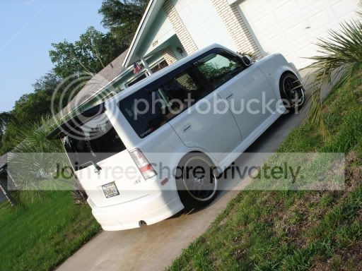

Does anyone know what size these wheels and tires are and if they are running any kind of spacers or anything? I mean width and everything. Thanks guys

hey. the size of those should be 18x8.5 in the front and 18x9.5 in the rear. thats the set up i use on my PW xb with Sportmax 006.. u'll have to run OTG spacers (10mm) and a spacer shim(5mm) as for the tires... fronts would be 215/35/18 and rear - 225/35/18.. u'll get about a stretch look on those tires.. BEWARE though with this wheel set up.. if ur lowered ( im lowered 2") you'll rub.. i had to roll my fenders.. these wheels take a lil time and patients to get running right..
thats the same size setup as those 962

so i'll need a 10mm spacer for the rear and 5mm for hte front? it just looks like bbist's setup sticks out a bit more than your's maybe it's just an illusion to me. lol

you'll need a OTG 10mm rear spacer with a 5mm spacer shim.. so the rear has a total of 15mm spaced out.. i think the bbist one has a total of 20mm spaced out thats why it sticks out more

So if I run no spacers on the front and 15mm worth of spacers in the back, my setup will look similar to Nokia6230's setup? Also I've been told I should get extended lugs for the back since I'm using spacers just to be safe. Is this required or would it be a good recommendation to do this?
