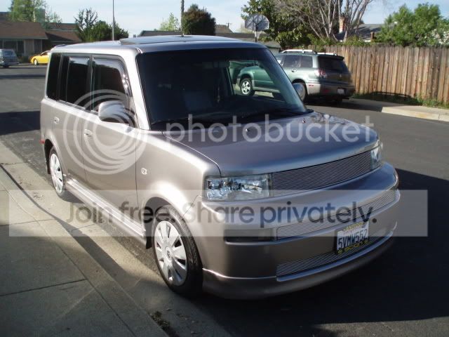

I used the oven method. I put them in the over at 250 degrees for about 15 minutes that was enough to melt the glue. So far no fogging, just reheat after you take them apart and push them together pretty hard. If you have any questions let me know.
