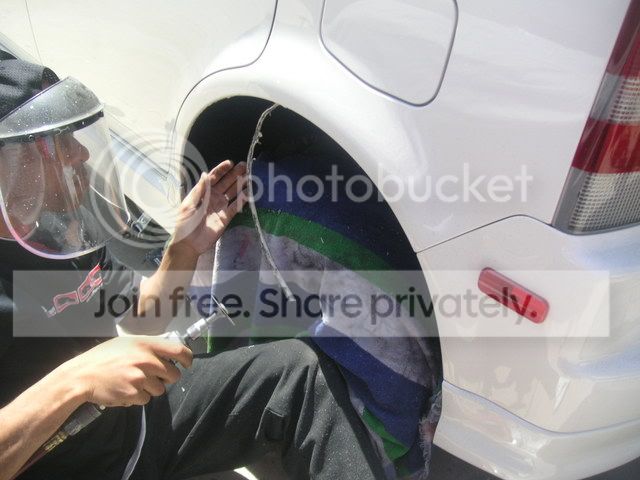

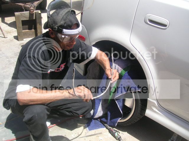

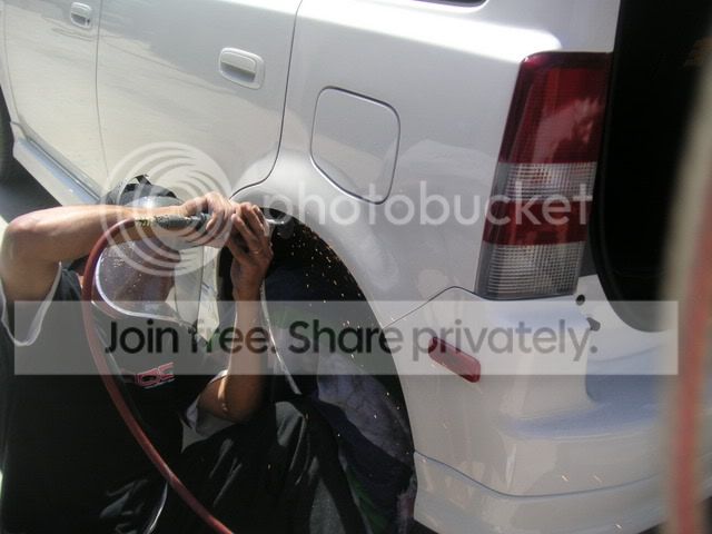

What the heck is going on here??

Cutting out the inner fender well instead of rolling them

Yep. I refuse to take out my OTG spacers with my 504's. No roller handy, no patience for the baseball bat.

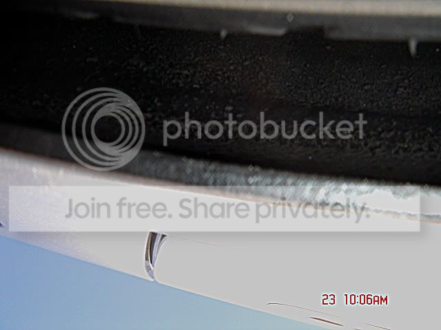

use touch-up on the bare metal edge, let it dry, then mask the shiny bits off and carefully hit it with a can of undercoating.

i did this too for mine, sanded it down, smooth out the bar metal, rust treated it and then sprayed it with bed liner.

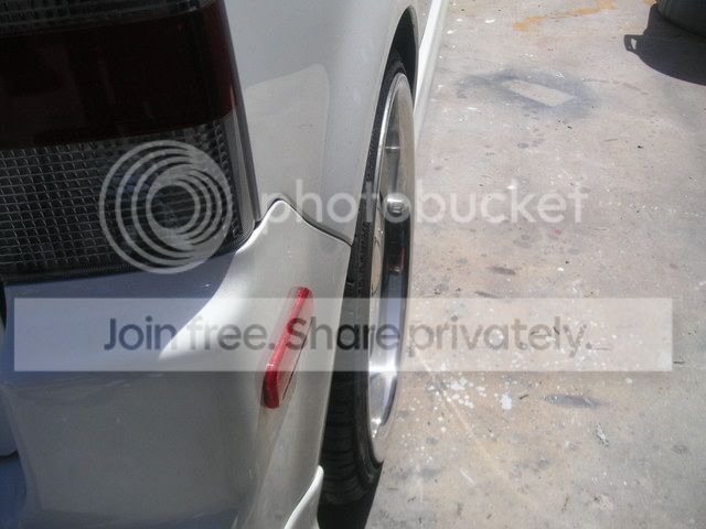

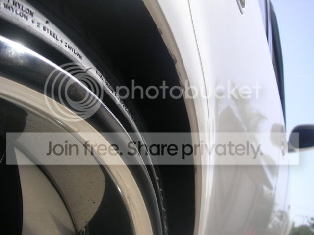

You all make me smile. This is still a fun place. Anyway, no worries about anyone else owning this box, it's mine for life.
Rust worries??... In San Diego??... Nah. Besides, there's always Rhino Lining or Rust-O-Leum!! There's actually about a 1/4 inch of the flange left. Didn't trim for looks, the flange was just scraping the rim protector on my new tires. Sounded worse than what it was, but I felt I had to do something. And patience is not my virtue!
