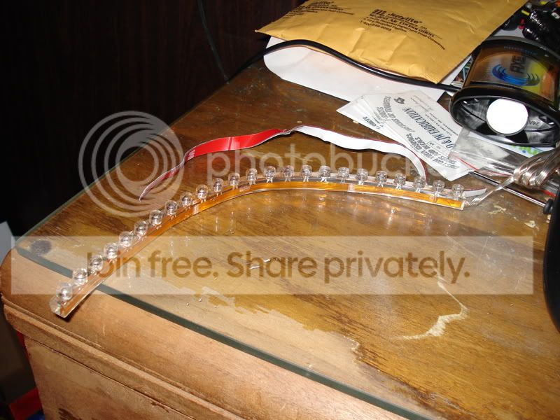

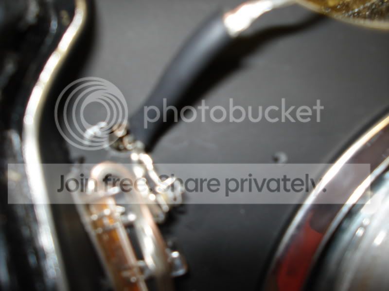

ok I got this idea from Oznium, after searching their pages for several days, and needing to reseal my headlights anyway I figured I'd add a little color in my lights, so here goes, also as usual I'm not responsible neither is scionlife, if you screw anything up, just try and take your time

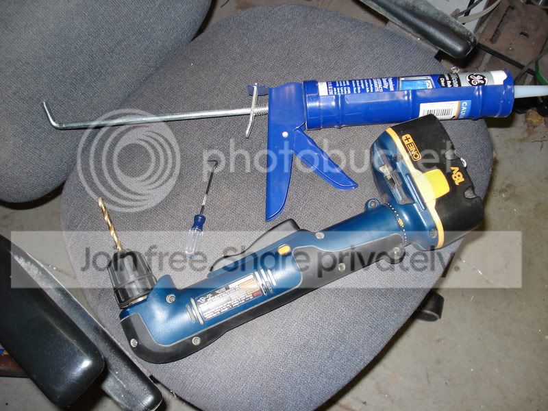

for this you will need, a drill, a drill bit, a pick tool, some alcohol pads, and silicone
step 1. opening the headlights there are several DIY's for this, I used a spray booth at work that was on and running set them in there for a little while and pulled them apart inside, how you do this is up to you though

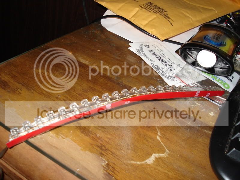

step 2. clean all areas including the leds and the inside where they will be stuck, also check your parts, make sure the leds, controller, and double sided tape is there

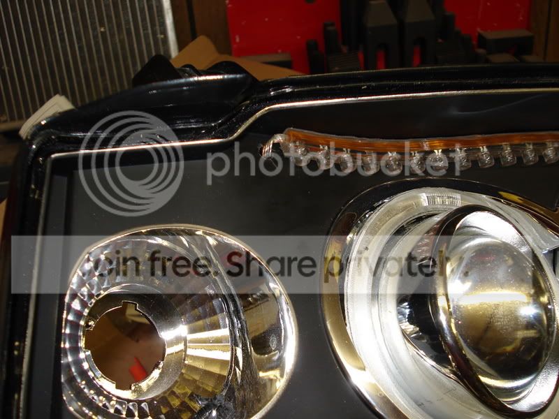

step 3. decide where you want to put them and how, best to do this with the leds on so you can decide how to place them

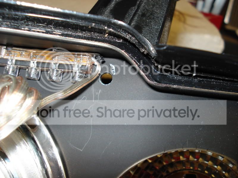

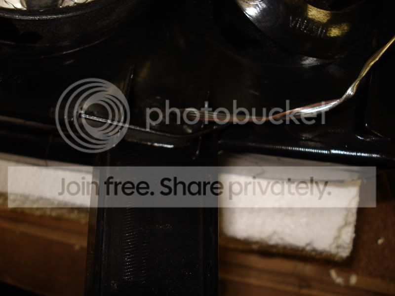

step 4. carefully stick the leds in your headlights as far back as possible

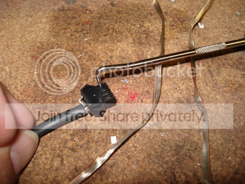

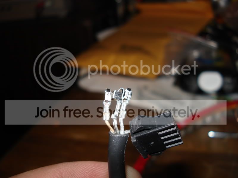

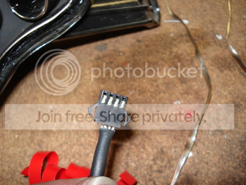

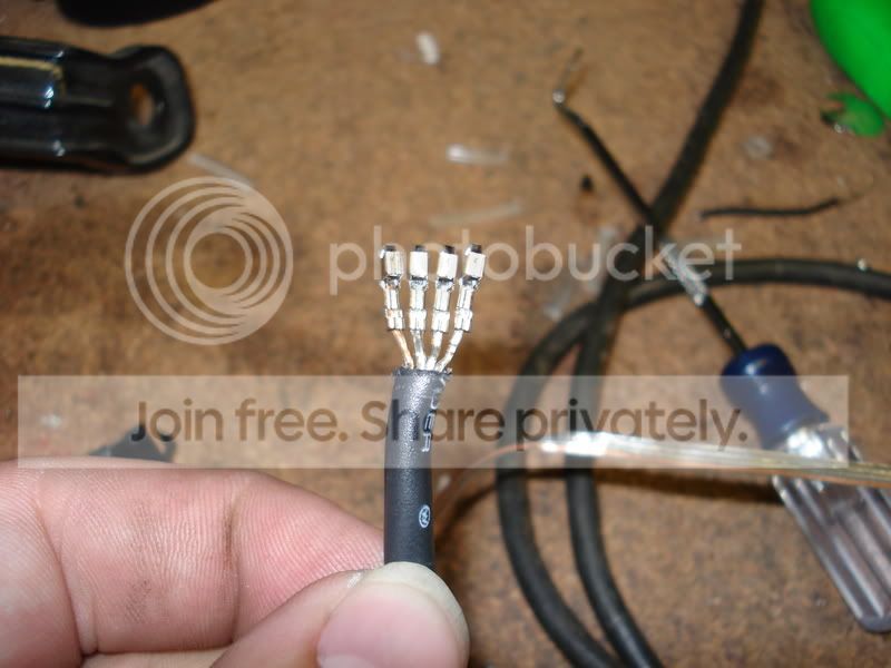

step 5. this is the tricky part, you need to remove carefully, the plug on the end, its easy to do with a pick tool, note where each wire went.
step 6. you need to drill a hole thats slightly bigger then the rubber on the end of the wire
step 7. carefully feed each prong and the wire through the hole, then reassemble the plug.
step 8. seal the hole with silicone.
step 9. test and make sure you got everything right.
step 10 reassemble lights and reinstall them in your car.

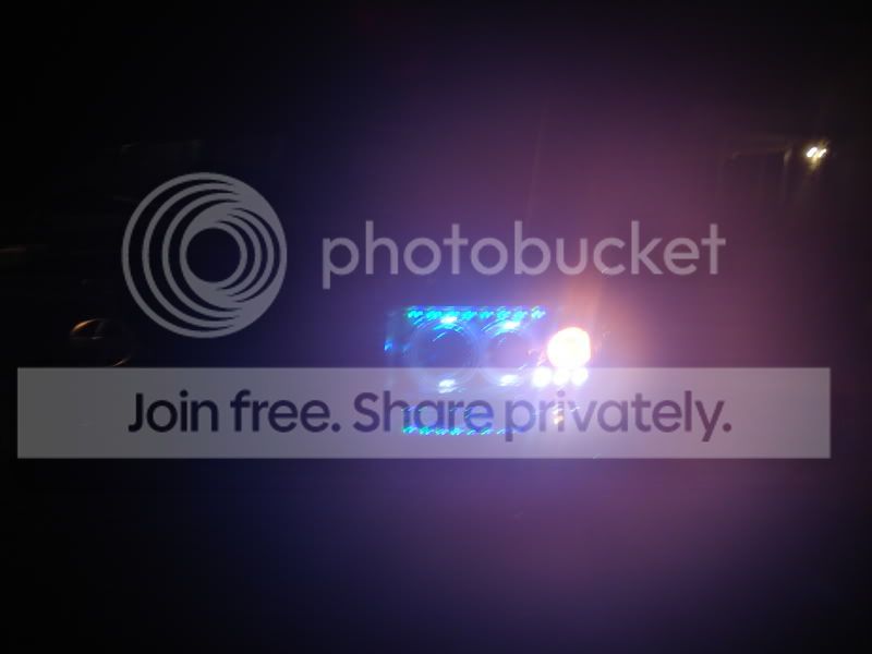

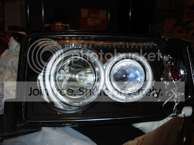

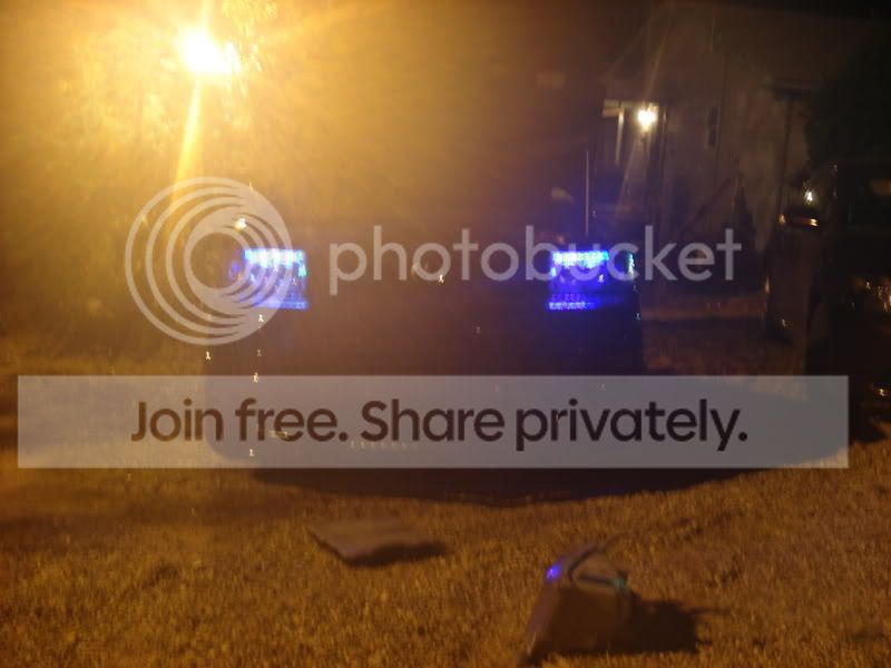

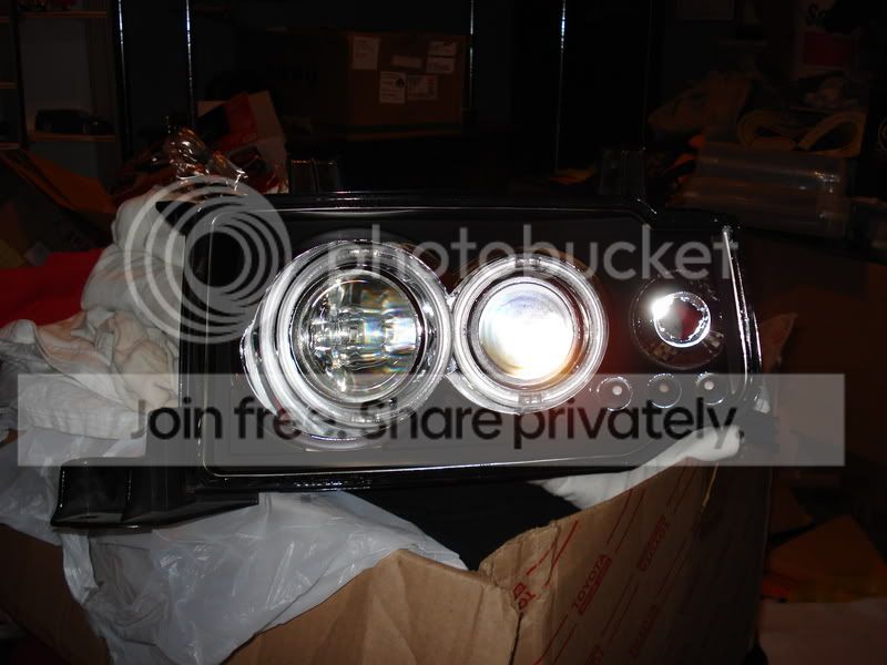

installed on the car running lights/halos off

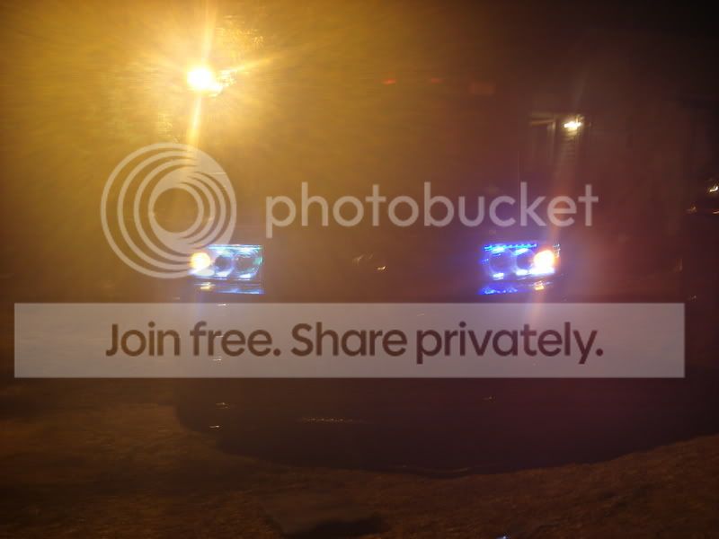

halos/running lights on
close up
I'll take more pics when everything is finished still have to wire them in
