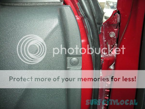

Remove the Phillips head screws from the grab handle, the door latch handle and the area to the front of the panel near the door jam.

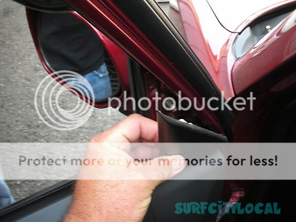

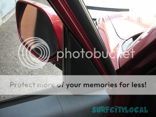

This part is not required but I do it to make the job easier. Remove the black triangle piece of plastic above the door panel.
Just pull and it will come off.

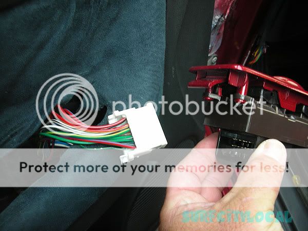

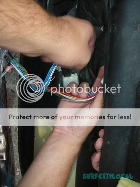

Disconnect the electrical leads for the power windows and the stock stereo speaker wiring if you are still using it.

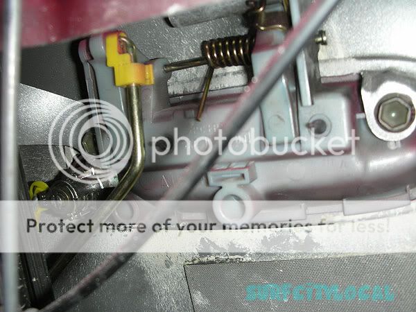

Pull back the factory plastic liner being careful not to tear it, you will be able to see the door handle from the inside.

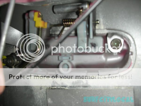

There are two rods connected to the front door handles, these will need to be removed. There are yellow plastic holders keeping the rods attached. By pulling the plastic keepers off you will be able to remove the rods from their mounting holes on the door handle. They can be a little tough to pull so take your time.
There are two 10 mm bolts holding the door handle in place. Remove these bolts and the door handle slides right out.
