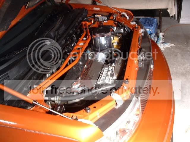

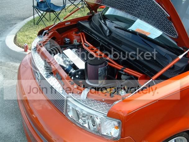

Here is a picture of my engine compartment. the air filter didn't fit like I wanted it to so I had to turn it up for now. Still looking for a very tight 180 bend to make it lay flat.
[img][/img]

Very nice! Did you make the cover over the headlights and grille? I'm looking for something like that.
Old Aug 1, 2006 | 07:54 PM
  #129
hip_2b_sqr's Avatar
Joined: Apr 2004
Posts: 646
Yes, I left a couple of small tabs at the back of each piece and bent them up to lap under the piece it's attached to, then drilled the holes through both pieces. The diamond plate was easy to work with and I used some of that door edge guard stuff around the edges so there would be any rough finish on the cuts.

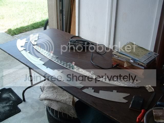

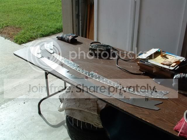

Frosty, here are a few pictures of when I took off the diamond plate trim pieces and made new one from an alum. sheet. After clean up, I made you a tracing of the pieces.
[img]
Good luck[/img]
