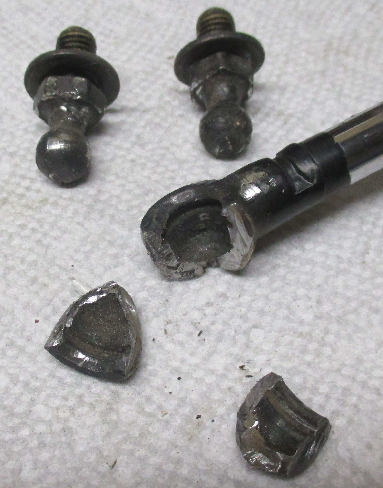

Finally got around to replacing the struts only a year and a bit later...
I did put a Dremel to it, using a cut off wheel to cut out a large chunk of the head end. I was a bit worried that
I would not be able to remove the ball and put in the new ball that came with the new struts, so I did not cut the ball off.
Cut a couple of deep grooves in the head end then used an old screwdriver to pry the gaps open. Once I got the chunk out, the retaining C ring started to come out of the groove. Once I got the ring out, the end came off easy.
The bolts at the other end came out fairly easy, even though I think they had been Loctited in.
I was able to remove the ball bolts with a deep well socket and they were in super tight, I would guess something like wheel nut torque. They had used red locktite on the threads. An open end wrench was not going to get these out.

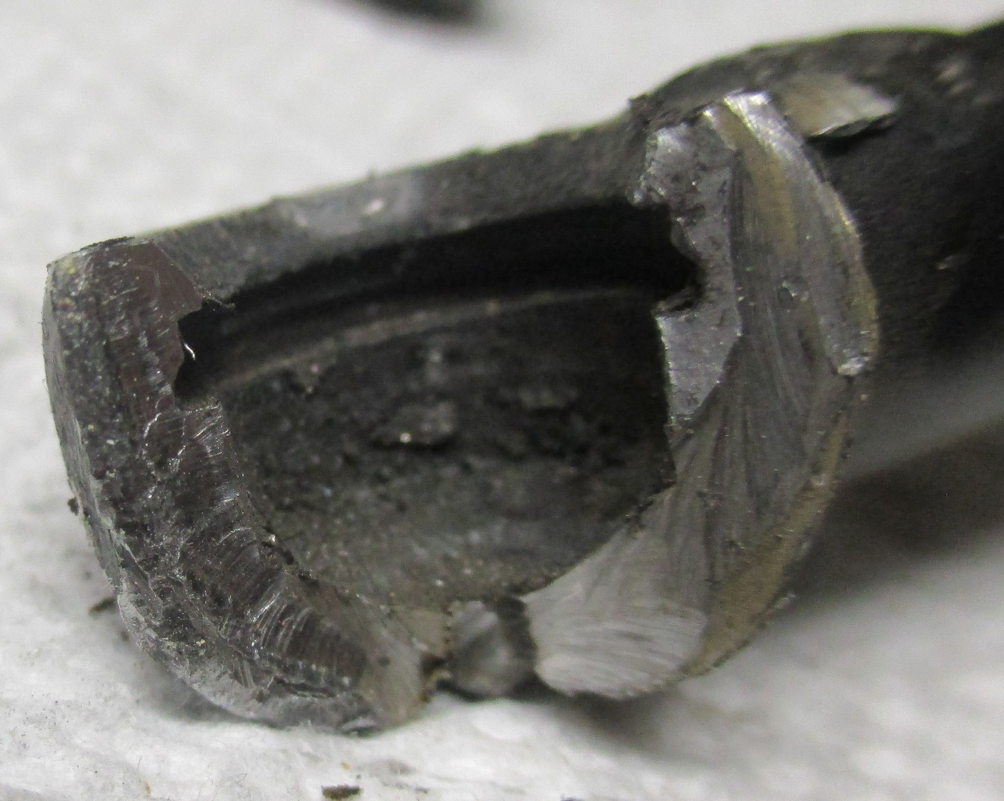

Here's that groove where the C-ring was. Limited access means that ring wasn't coming out without a fight.
The new struts have an externally removable wire, so next time, replacing them will be easy.
