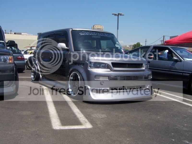

Ok behind every cars bumper is a metal beam. For the Scion xB, this beam has to measure up to certain US regulations. The Beams were beefed up so inturn, the bumpers had to be modified from the JDM counterpart to accomidated them. The bB (NCP30) does have smaller bumpers and does have a crash beam in the front and rear but are not as heavy duty as the US xB. I didn't want to take the effort in finding NCP30 crach beams and mounts so I had to remove mine to let the JDM bumpers fit.
YOu can see in the pic of how close the fogs are to the edge of the bumper compared to the US bumper. As for the rear, its just shorter over all. Also the bumpers are JDM and not Euro just so you know.
