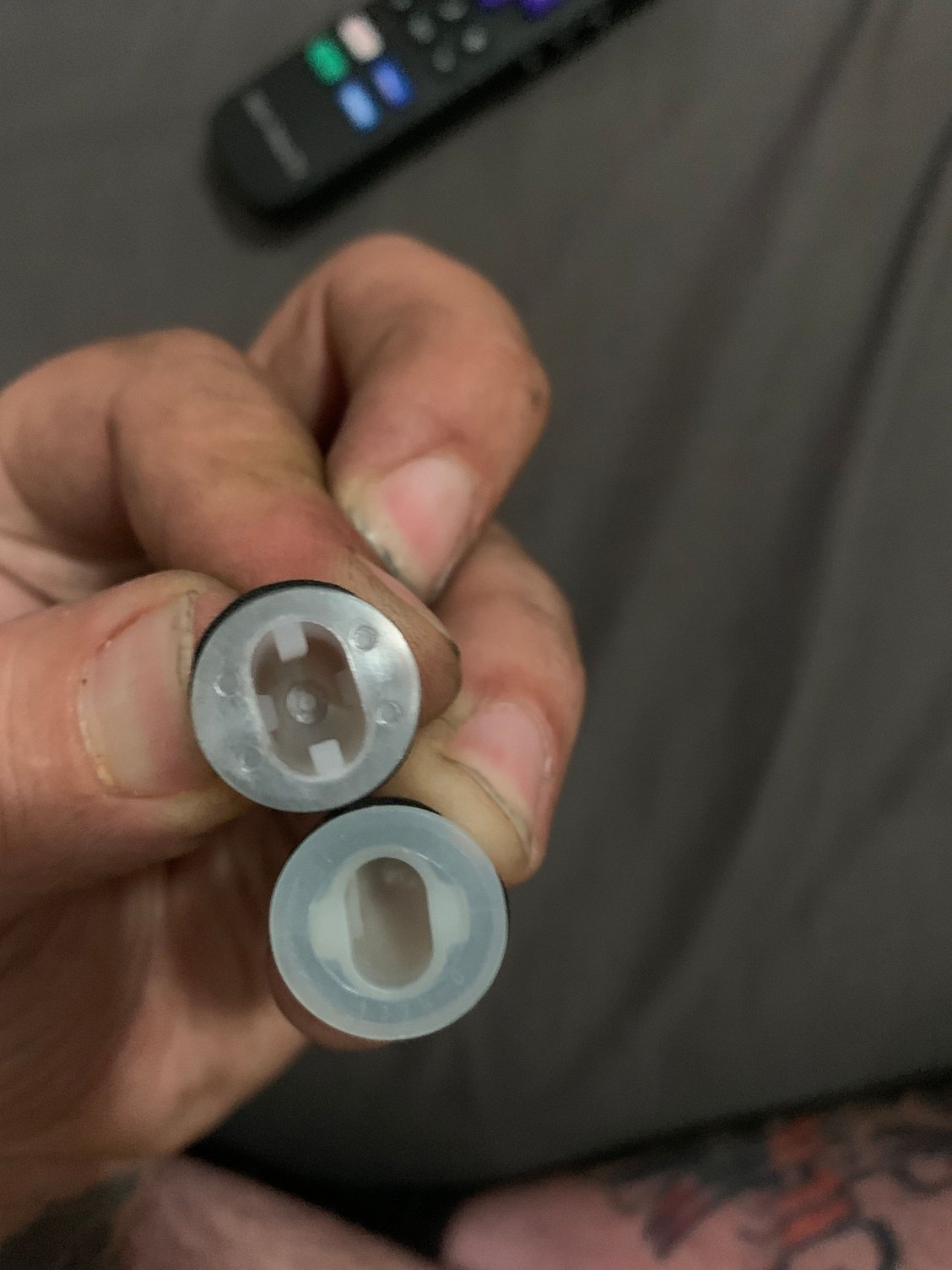

So, the top plastic grommet is the one I sourced and the bottom on is the one that came in my kit. There is a slight diameter variance, by t they both literally fit on to the lower mounting tab of the spiller the same way. Also, the top one seems to make sure the pin on the back of the spoiler stays centered in the grommets.

Just out of curiosity how wide is the tab on the spoiler and how wide is the center portion of the grommet you sourced? Worst case a little trimming would fix it and you could even 'mimic' the stock one if you really felt compelled to do so.

I just test fitted one of the sourced grommets to the pin on the back of the OEM spoiler to see how it would fit. It fits perfect. Actually snaps in to place. I had to use a panel trim remover to take it back off. So other than being a slightly smaller outer diameter, the inner diameter is dead on.
