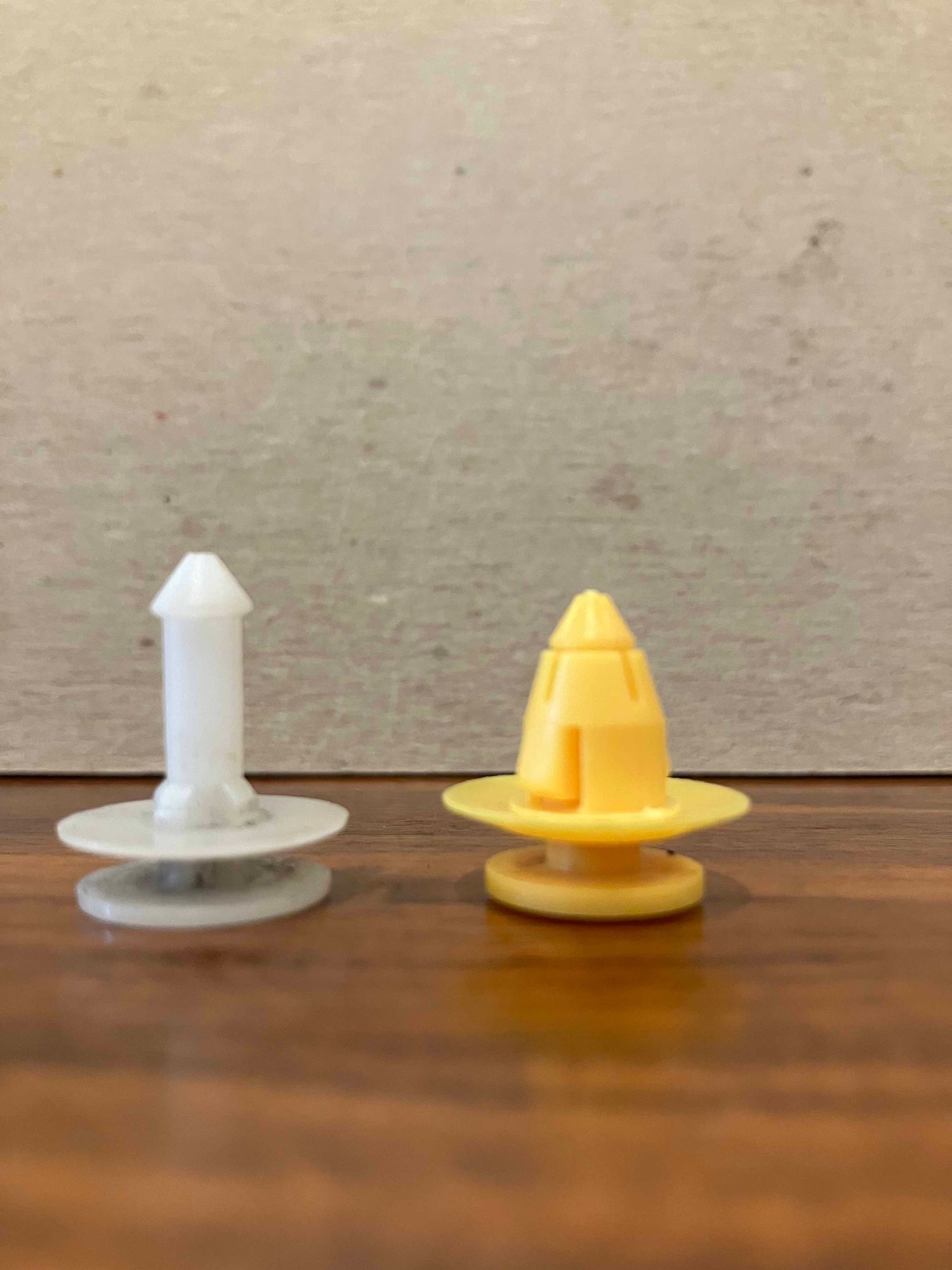

I recently purchased a 2005 xB. One of the rocker panel moldings was sagging, so I removed it and discovered a few of the attachments clips were broken. When I got replacement clips from the dealership I noticed they looked different (shorter, yellow). I mentioned this observation to the parts counter clerk and he assured me these were the right clips, same ones that Toyota had been using on all models. Well, sometimes I hate being right, because the new clips are too short and won't lock in properly. Has anyone else run into this, and if so, can you direct me to clips that might actually work? Any insights appreciated!

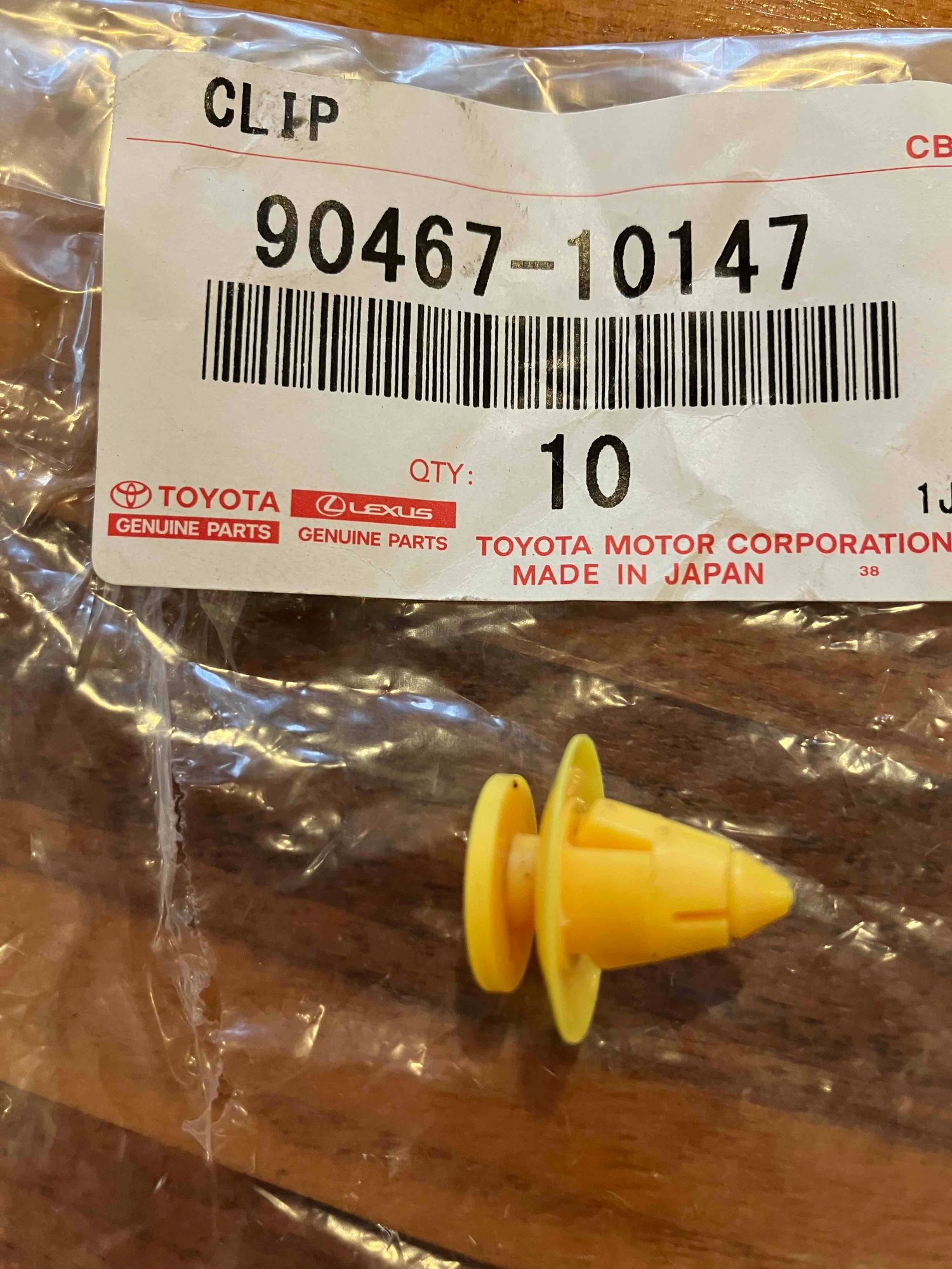

Yes, the part number matches the parts diagram (Rocker Molding Clip – Part Number: 90467-10147). However, there is a similar part that is shown in the exact same location in the diagram (Rocker Molding Retainer – Part Number: 76924-02010). Unfortunately, the part image is only a line drawing, so I can't tell if it's different than what I received from the dealership. I'm attaching photos for reference. White clip is what came off the car. The yellow is what I got from the dealership.

Here' a photo of the part number you posted. Aftermarket?
https://www.fastener.zone/products/a...ta-76924-02010

Ah,that makes sense. Those are the clips that attach the underside of the rocker molding. Haven't made it back to the parts counter yet. Stay tuned!
