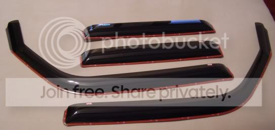

1. UNPACKING. Inspected for damage, none found. Box included pieces for driver's front and rear and pasenger's front and rear, two alcohol wipes, and a one-page instruction sheet.

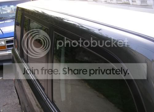

2. BEFORE. Here's the "before" picture. Roll down all four windows completely.

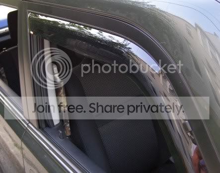

3. TESTING FRONT. Before removing the sticky tape, test-fit the parts to decide how best to jam them in the window channel. I found that starting near the pillar and working toward the mirror was easiest for the front.
4. NOTE. Fit (I hate "fitment") was not perfect; some of the tape was exposed. Hope I can minimize that later.

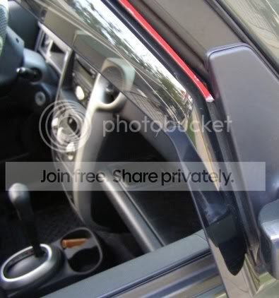

5. CULPRIT. Found why mine didn't fit so well. The bottom corner where the window channel is closest to the mirrors is just a hair too long and scrapes against the door moulding. I used a plastic saw (for cutting model airplane Styrene) to trim about 1/4" off the bottom of the angle. Cut is not noticeable and looks factory, and helped the fit a great deal. That's why you test-fit all parts first!

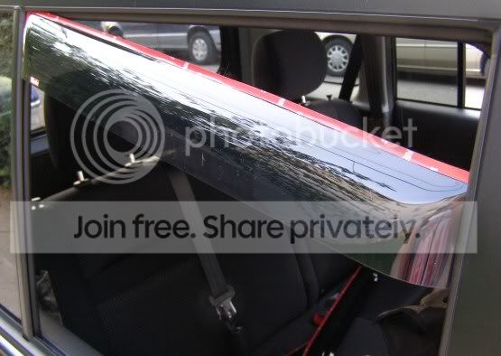

6. TESTING REAR. Also test-fit the rear pieces before removing the 3M tape covers. Insert at a 45-degree angle, push one corner up into place, then the other slides in. No fit problems.

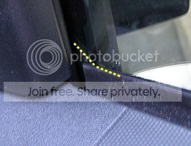

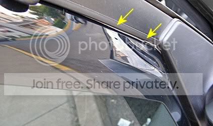

8. INSTALLING. Fit the pieces into the window channels just like you did in the test-fits above. The set I got was still not a perfect fit. The yellow arrows below point to a thin sliver of 3M tape visible from behind the vent shade. Not very noticeable unless you're right on it. Later I'll try to remove it using an X-Acto knife and Goo Gone.

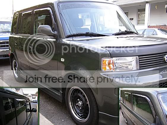

10. AFTER. Installed! Looks tight. Have to keep my windows rolled up for 3 days, but there's no increase in wind noise and no rattling. Approved!
