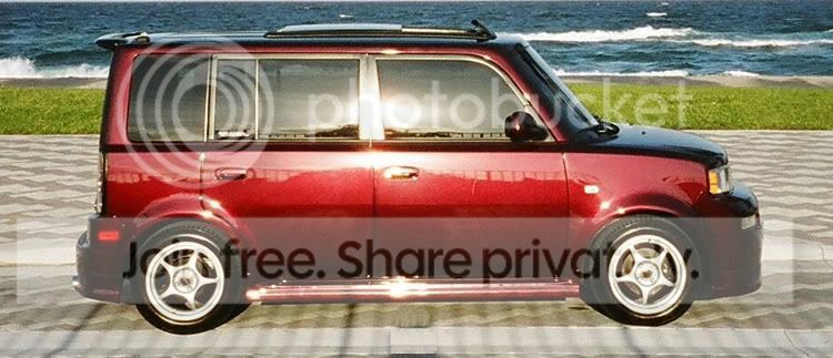

15" ENKEI RPOJ-2 rims
Kept the GOODYEARS on mine, since here in SOUTH FLORIDA, they run fine. I would be changing them, however, if I lived in snowy areas. EAGLES don't seem to like the snow much, IMHO.
