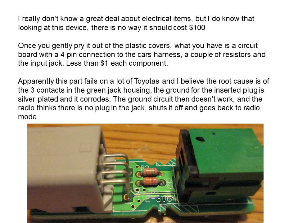

While fixing the blower fan, we tackled another common problem that there may already be an answer to on this forum. Save yourself some money if the AUX jack is your favorite way to get songs into the sound system and it is failing.
