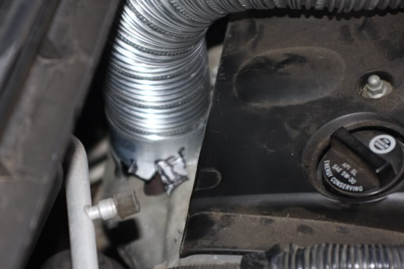

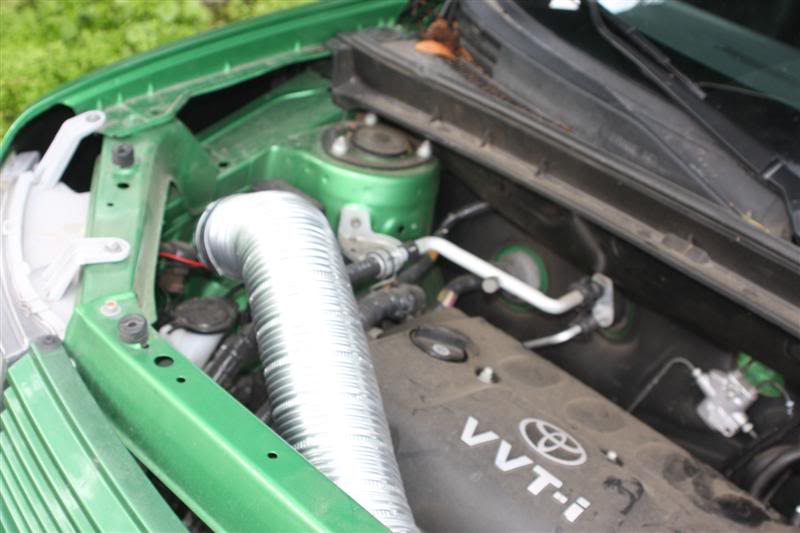

I just finished a warm air intake project, and will be doing final testing this week. Initial testing with the uninsulated WAI showed only a 25 degree intake temperature rise, and no significant mpg improvement. Now it's insulated, and we'll see if it works. The theory is warm air is less dense, and needs less gas to burn at the stochiometric ratio - essentially the opposite operating theory of a cold air intake.
Below: WAI taped over OEM air intake horn.

Below: WAI intake simulating original intake position behind radiator, for original A testing.

WAI...a bad idea in my book....colder condensed air is best for milage and performace
adding warm air should degrade your performance.
I'm interested in what you find out though

You are partially right ...
A WAI will degrade performance by causing a lean burn condition. RUnning lean is not good for performance but really good for Fuel Economy. So there begins a major trade off between wanting to drive fast or tricking your ECU to help you save gas ...
