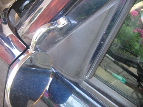

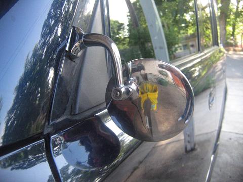

I've ordered the mirrors, but they haven't arrived yet. I got the Maltese Cross chrome ones since the Surfers Cross is the Maltese cross. I painted the surfboard to look like wood; it was originally fiberglass. Below are some before/after pics of the board.

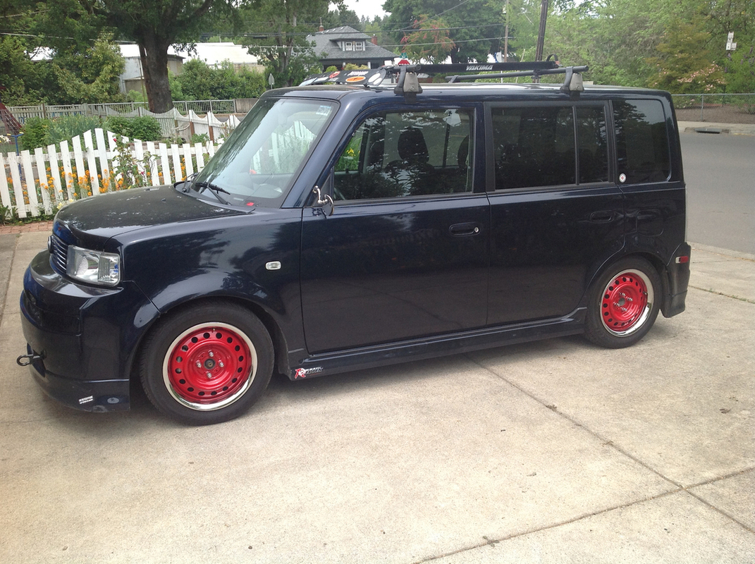

This is what I did...
Old May 26, 2012 | 06:41 AM
DATXB's Avatar
Posts: 53
From: Cottage Grove, Oregon
If youd like, I can explain how I filled the area where the mirror was mounted. Not at home right now, but I can post some pics later... Let me know...

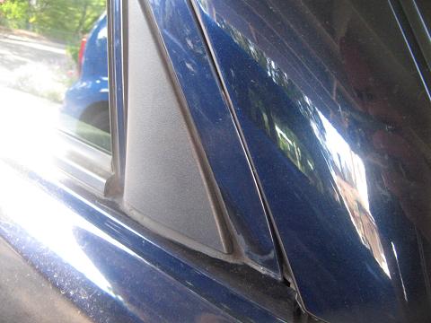

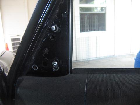

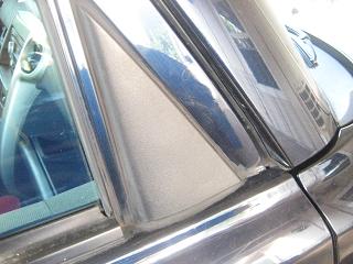

Ok, as soon as I get home, I'll do that. The black filler is actually the inside trim piece that covers the mirror screws. I used the passenger side one for the driver door and the driver door trim piece for the outside passenger side. They needed a little trimming and then sucurd with black rtv sealant and a screw or two. I'll send some pics for you...

@Breezer, here are the up close pics. trim the covers so they fit nice. the mirror screw holes line up close so you can screw them in for extra support from the inside. If they don't line up, drill your own. Check your local wrecking yard for some new covers for the interior. Good Luck!!
I'd like to see the car when your done with the wheels and mirror!!
