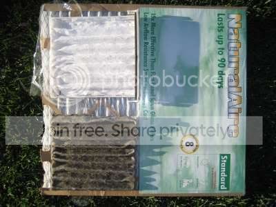

But more on topic, I decided to replace my cabin air filter. DIY model of course, thanks to SL! I have had my box for just over one year now...so that filter is about a year old.

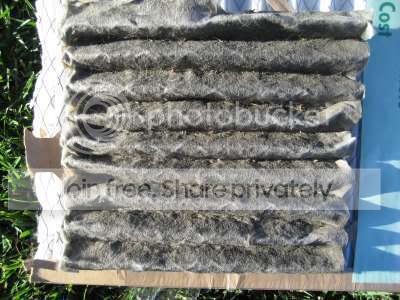

UGGH! I am shocked by how dirty it is and how much it has stopped from entering my xB. Not only blackish dust and dirt but big chunks of leaves, seeds and what not.
I still have four more to go on my Home Depot filter blank. What a deal-sure beats the dealer's price. I am definitely going to replace it much sooner next time!

Close up:
New and old:

Great pics, Robert. It shows how much stuff comes in and is caught by the filter instead of clogging up everything else. Mine looked about the same, with maybe a few more large chunks...
