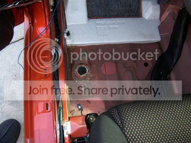

Here are the pictures of said drain plug.
It seems that the carpet is going to be ok. I let it dry out and sprayed it with antifungus / bacterial/ mold/mildew stuff.
I ran the water hose on the car for about 5 mins to see if the water could be coming from anywhere else, but it seems as though it is coming from underneath as I drive. It still seems strange to me that there was so much water soaked into the padding.
Since I have the carpet out nows a good time to run some dynamat material on the floors.

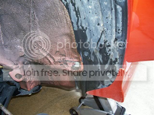

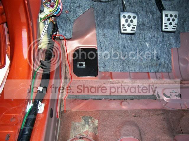

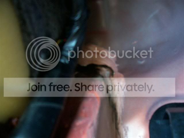

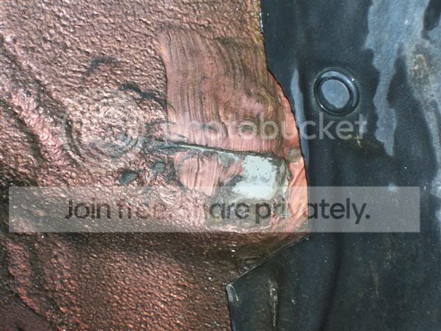

I went back and looked over the seams once more and found this dirt line coming from the left drivers side corner, near the dead pedal area. I then took a harder look and I could see that the seam was busted. I looked on the outside wheelweel and there was a 3 inch line (the seam) completely exposed. I then ran and grabbed the hose and proceeded to spray water on the seam from the outside, and sure enough all the water came rushing into the car.
Im damn glad I found this before I put everything back in. I went and talked with the guys at the dealership and they said it would be cheaper and better if I fixed it, since it wouldnt be covered under warranty. SO I grabbed some Steel reinforced epoxy and some rtv sealant, and seal the inside with rtv sealant and then sealed the outside with the steel epoxy. When everything is cured (24 hrs) then Ill go back and spray over the epoxy with rubber undercoating just to be on the safe side.
Here are some pics of the seam.
Ill post pics of the finished product, and how well it works.

Originally Posted by unc25
... found this dirt line coming from the left drivers side corner, near the dead pedal area. I then took a harder look and I could see that the seam was busted. I looked on the outside wheelweel and there was a 3 inch line (the seam) completely exposed.... talked with the guys at the dealership and they said it would be cheaper and better if I fixed it, since it wouldnt be covered under warranty....
Tell us more about this seam in the body that "busted" and let water into the car and is not covered by warranty.
It looks like the seam is a actually a horizontal gash - some kind of damage. What do you think caused the gash?

There does appear to be a weld tab that would appear maybe like a seam at that spot. My xB has no nose on it atm so was easy looking. Around yours looks like hammer marks. Did you hammer it?? Tire clearance perhaps? I did! But I resealed mine just to be sure. If you did not hammer there look at the other side see if it looks like hammer marks seal if it does. My xB is pretty flat (no dimples like I see in your photo in that area).
Old Dec 21, 2006 | 12:33 AM
unc25's Avatar
Posts: 24
I think the guy before me messed around with it either to clear the tires, or he hit something in the road. Im guessing he hit something in the road due to the fact that the passenger side wheelwell has no visible signs of tampering.
That Epoxy is hard as hell now! I shouldnt have any other problems out of that spot.
Thanks guys.
