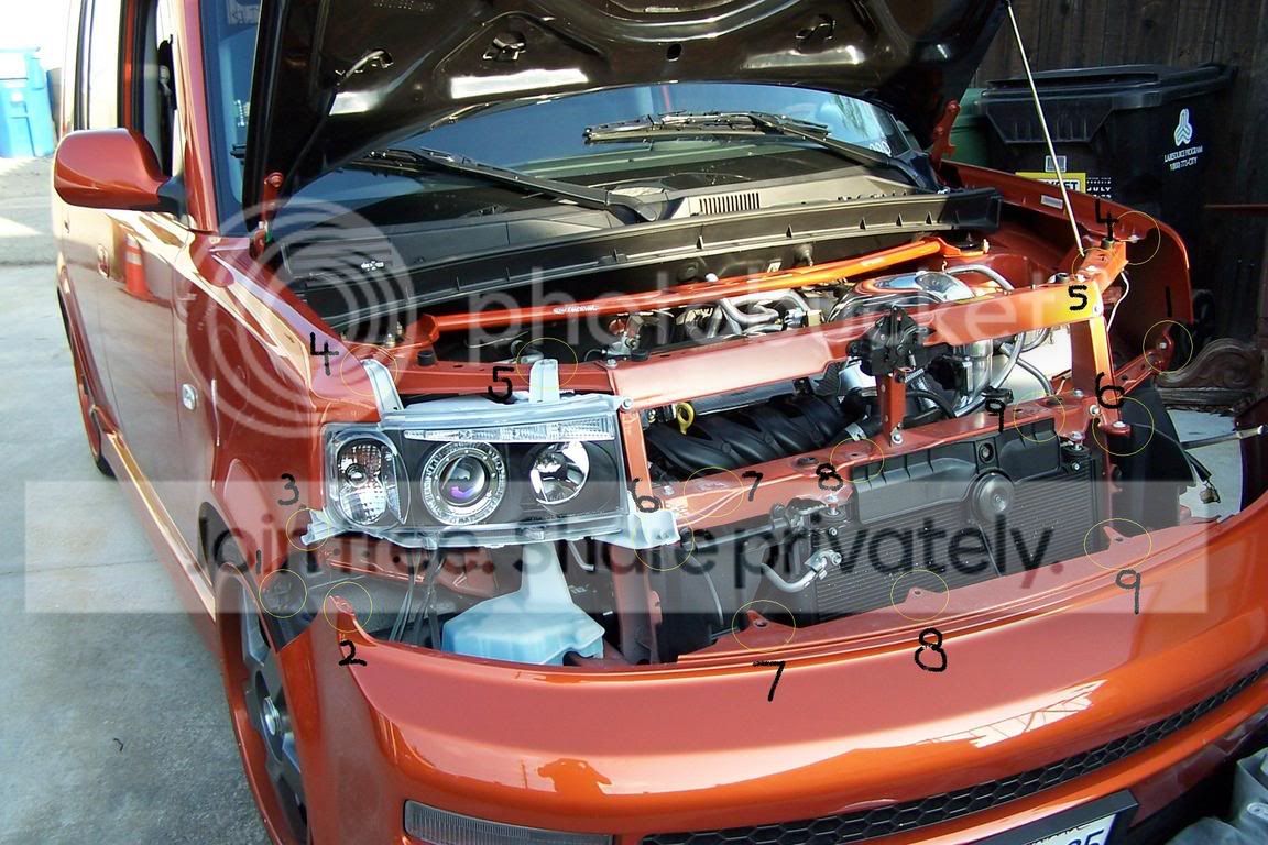

okay i go to put on my headlights only to figure out that i hafta take off the whole front clip! what the bloody hell is that about ? please tell me that there is an easier way to do this. thanks folks!

remove all the bolts w/numbers.
it's really very simple.

That is very nice! It really is easy to do, and with those pics it makes it so much easier to view. HumanTorch thanks for taking the time to do that!!!!! That is what ScionLife is all aboout!

This will come in real handy. Awesome illustration HumanTorch!!
