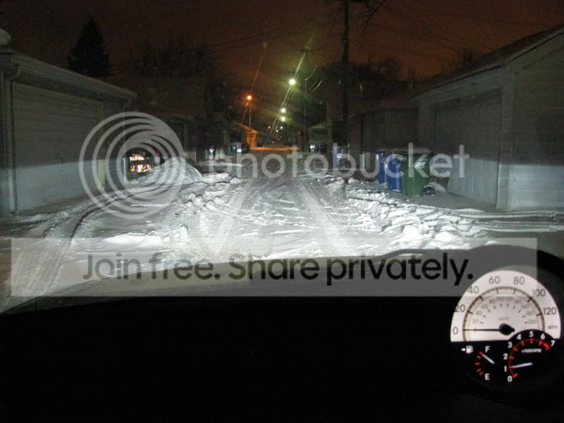

Here's my cutoff with 55W HID in my sonars. It's perfect. Game. Set. Match.

From: Bay Area, California
Pretty convincing, I'll admit.

Zero glare, razor sharp cutoff. It's perfect. HID in a reflector based headlight is where you get nasty glare, and H4 base is even worse (since the low and high beam is housed in the same reflector).
